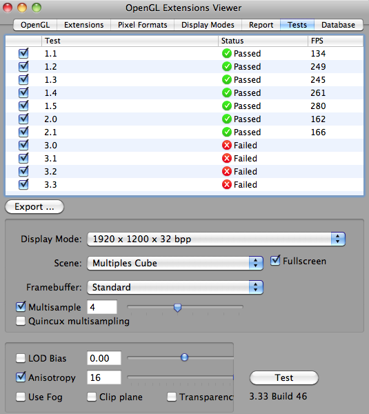

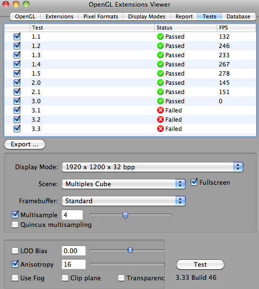

3. The OpenGL performance of the 480 is still weaker than it should be under OS X. It is now slightly below the 285 in most tests, rather then dire as it was with the June kext. Only 1.4 is better on the 480 (which will make it clear which shot is which).
With regard to 3, I have no way of knowing whether this is because
(a) the Fermi driver is still immature
(b) the Q4000 driver is just not that well-matched to the older 480 Fermi chip
(c) the injector is compromising bandwidth somehow

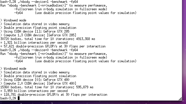

One place where the 480 is MUCH better is double precision CUDA work. Despite being crippled compared to the Quadro and Tesla, it is still over twice as fast as a 285. In Single precision I have got over 700Gflops on the 480, but only on larger problems.
I attach some screen shots showing the still lacklustre OpenGL, but very good DP CUDA. Note that the OpenGL folk seem to have changed their test structure, so these numbers cannot be compared directly with some of the older ones on the forum. Also it looks like OpenGL 3 support is kinda half-there...

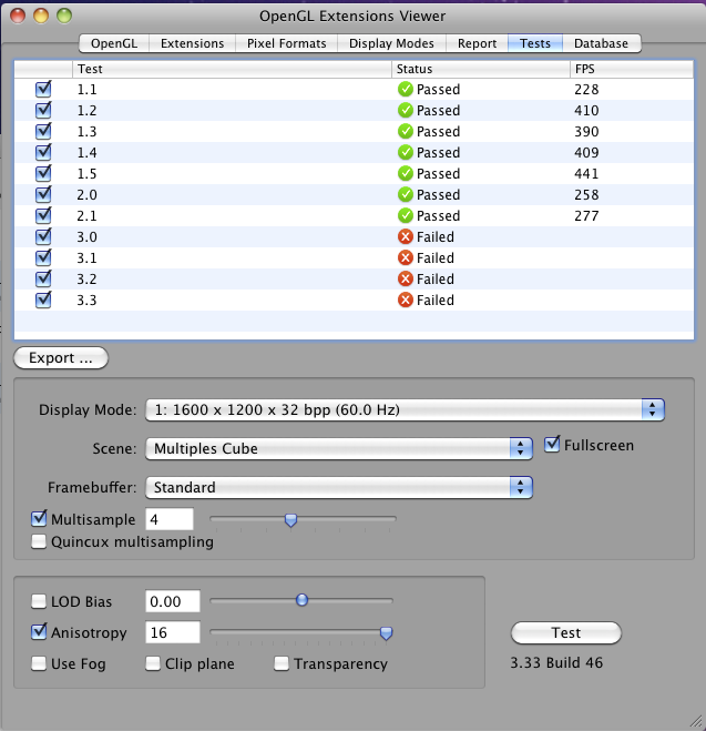

Weird! Here are my scores with a 480 and the same settings, though I'm running osX86.
I could be wrong, but you may have to edit your AppleGraphicsPowerManagement.kext/Contents/Info.plist depending on which Mac Pro version you have.
For example, I'm using Mac Pro 4,1 and most cards, even 2xx series, have been running at level 0 instead of 2 since 10.6.4. For a GTX 285 Vendor10deDevice05e2 needed to be changed to Vendor10deDevice05e3. For my 480, I changed Vendor10deDevice05e2 to Vendor10deDevice06c0. I'm not sure if this applies to a real Mac Pro, but figured I'd at least mention it. Oh and if you have a Mac Pro 3,1, this shouldn't be effecting your scores/results.

I have a Pro 3,1 (aka 2008) and had thought that was immune to the power management problem. The 480 is above the Mac 285, where I had previously put a second 2G PC 285. By the way, I put that back this afternoon and OpenGL viewer suggests the 2G bug might be gone (shot), which would make sense for the Q4000.

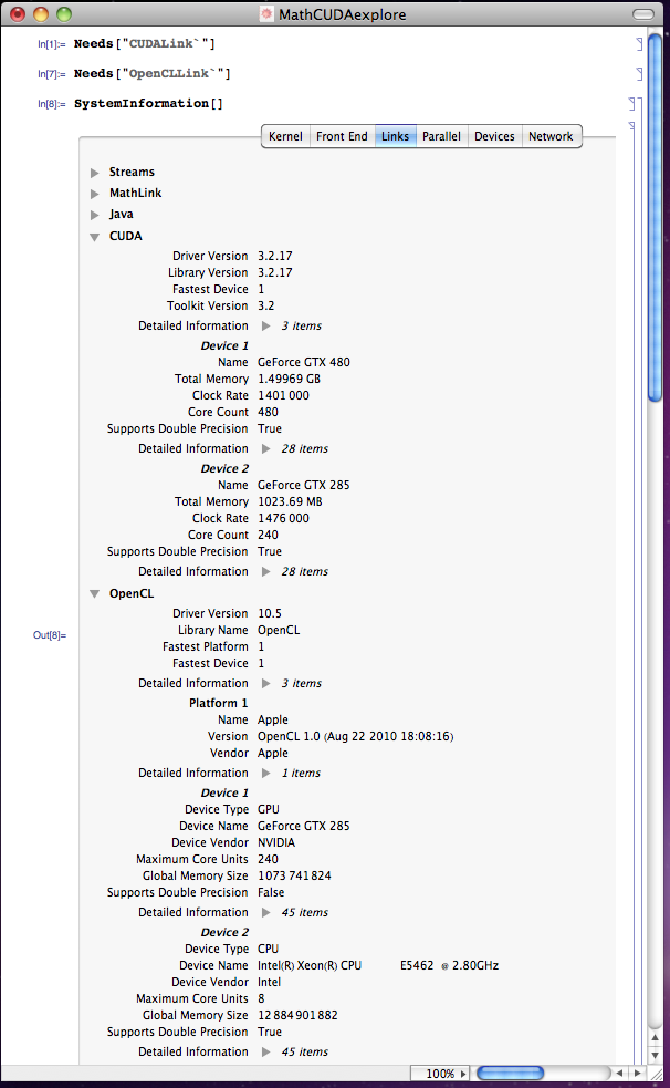

Meanwhile, Mathematica 8 talks to both cards (see shot) under CUDA. OpenCL is a bit iffy - the 480 is not seen and the GPU does not support double precision.

Jocelyn84, I followed your suggestion to edit that Info.plist and it really helped my performance. I'm still not getting as high of FPS as you are though.

4. I am wondering if with the OpenGL benchmark there is a part of the one I posted that is dependent on the CPU speed and not really testing the GPU in isolation. After all, my 2008 Pro has the Harpertown processors which are rather left behind by Nehalem, Core i7 etc.

Now I know the 2G bug looks like it is fixed I have put the 2G 285 back and will play with that for a bit. OpenCL recognizes that as well and Mathematica 8 is very happy seeing 2 CUDA and 3 OpenCL devs (2GPU + CPU).
Could this be the reason GPU Flame Fractal Renderer is reporting only 240 CUDA Cores instead of 480?
I suspect not. CUDA deviceQuery reports 480, as does Math 8 (see shot above). This looks like a different problem.

Do NOT use the multiple cubes scene to measure GPU performance in GLView. This scene is heavily CPU-Bound. You are in fact measuring CPU performance.
Just render the single Cube/Face scene.
