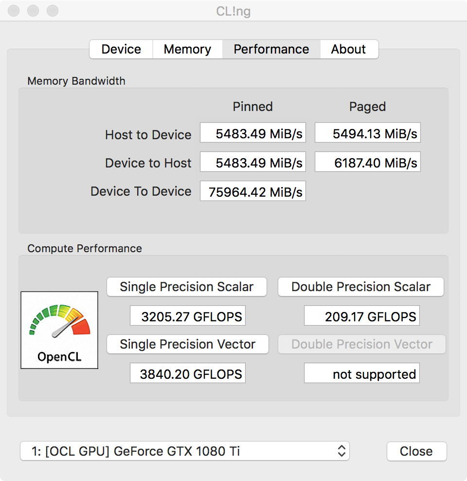

For macOS, that 2.5GT/s or 5GT/s doesn't really matter, especially for Nvidia card.
Simply go to Appstore, download CL!ng and run it
https://itunes.apple.com/hk/app/cl-ng/id1244392031?l=en&mt=12
Then it will show you the actual link speed. For 5GT/s, the "Host to Device" speed will be at ~5000MB/s range.
And that 2.5GT/s or 5GT/s in system info is not consistent.
AFAIK, with 138.0.0.0.0 or later.
All genuine Mac Edition card will shows 5GT/s
All AMD card should show 5GT/s
MVC flashed cards most likely will shows 2.5GT/s (but still working at 5GT/s)
Non flashed Nvidia cards should able to show 5GT/s, but no detail research in this area, not sure if different GPU family will have different behaviour.
https://forums.macrumors.com/threads/mp5-1-bootrom-thread-140-0-0-0-0.2132317/page-24#post-26383809

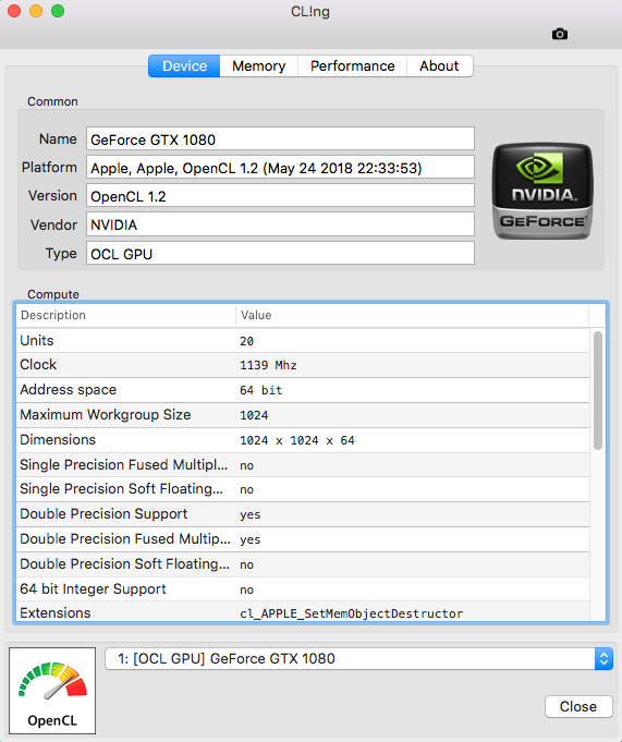

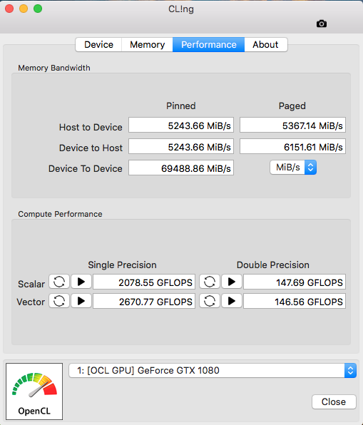

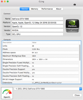

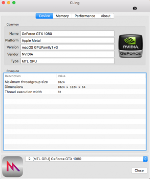

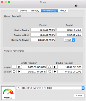

Screenshots with GTX 1080 FE (non-flashed/non-EFI) attached. Installed in slot 1, running at 5GT/s in High Sierra 10.13.6 17G4015 with 140.0.0.0.0 in authentic 5,1 and 387.10.10.15.15.108 NVIDIA Web Driver. System drive is NVMe via PX1 in slot 2.
