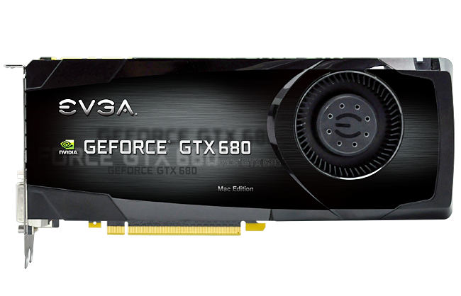

this is a photo of the official mac card (it says mac on it)
if it is a flashed pc card thats fine. the bios flashed on to it may have a slight overclock set to it if your lucky i gess

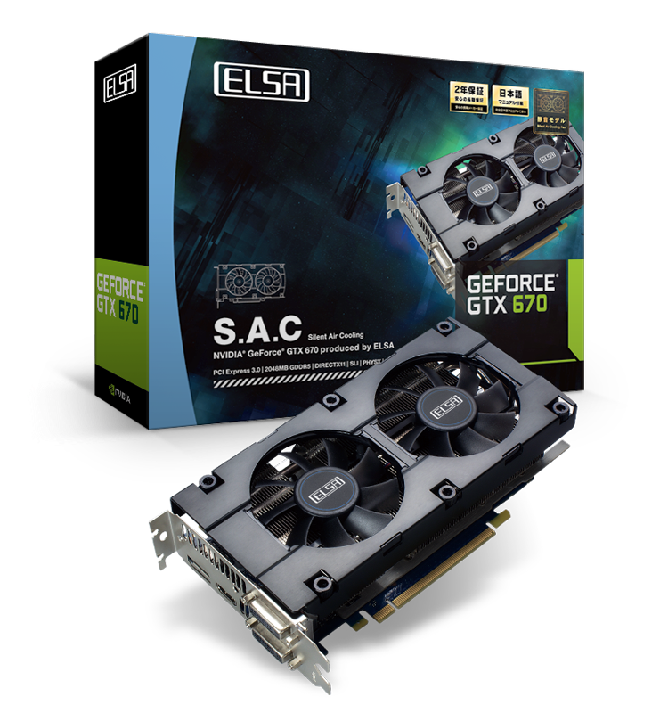

is this your card
if so then it's just a pc card (was it used?) looks like a Japanese model? (that brand is new on me)
thats not bad. lots of ppl buy pc cards and DIY flash them to mac, you just tend to pay a lot more for a pre flashed one.

I live in Tokyo and it's night time and I'll have to wait until tomorrow to check out Cuda-Z but I can say my GTX680 has two fans and it's gotta be the PC model. I didn't know this.
