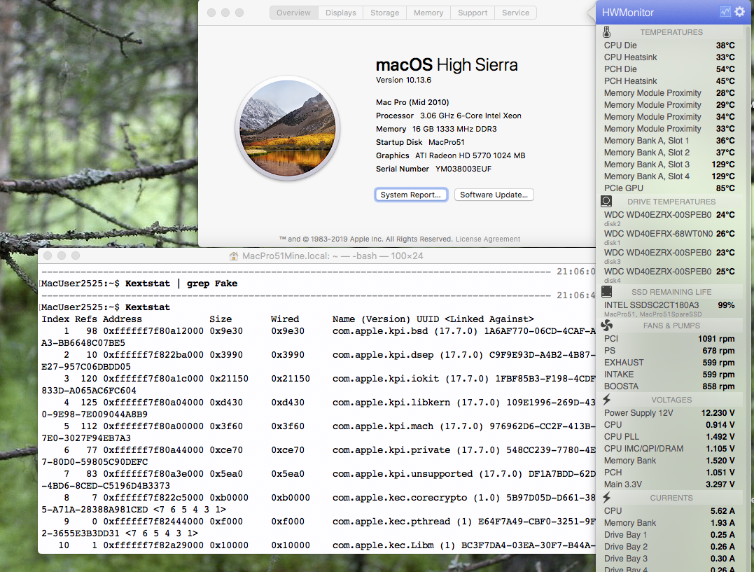

Try HWMonitor a hackintosh program that works for mac machine readings too. It will give you every reading under the sun.
I don't think this can work without FakeSMC.
It works perfectly fine all on its own reading the sensors on a Mac without Fakesmc.kext loaded..

Looks like your 5770 is very hot, always 85 degrees celsius. ?
Most times I have looked yes it is that hot. I do not use that machine much anymore it is mainly file storage for it now, turned on once ever week or so. I use my hackintosh now three times as fast using under 10 watts idle vs the Pro at close to 200. I did miss that heat last winter not now it is summer...

I mean cannot read the GTX680 temperature, can you see that the PCIe GPU temperature always stay at 85°C?
If it has the sensor it works for it I think, but now I fired up my 4,1 I see it has that for the temperature too. All the others I can see changing as the machine warms, up not the GPU so it looks like that is just a number it picks and stays at now I have checked again.

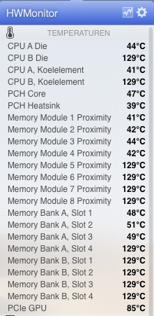

ok, installed hwmonitor today.
did not select FakeSMC kexts,
unfortunately hwmonitor i think cannot read the GTX680 gpu temps.
it only shows 85 degrees celsius, which is not correct.
looks like the same result als @MacUser2525 has.. ?
Is there perhaps another way for me to read my GPU temperatures.. ?
I've downloaded the app from here :
https://sourceforge.net/projects/hwsensors/
