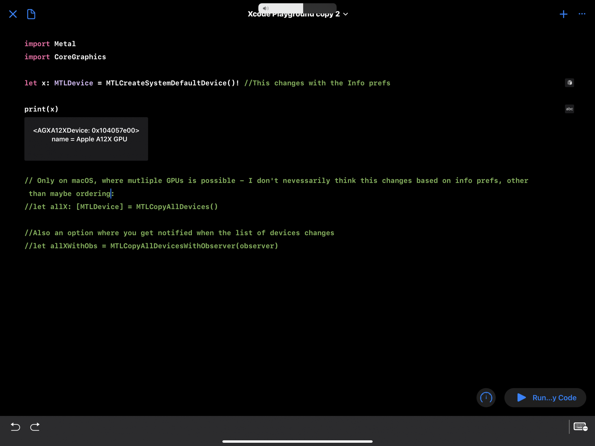

So I have no idea how League of Legends is programmed, but I wanted to add this; I have never tried an eGPU so haven’t tested how this kind of code behaves on an eGPU, but my assumptions are as listed
The CreateSystemDefaultDevice gets you a Metal device, and what GPU this returns in the code is likely based on the settings in the Finder Get Info panel, but apps on macOS can also ask for the full list of Metal devices and do their own selection; The order they come in may be affected by the setting in Get Info, but I don’t see it very likely that the list will be cut down in case the app can use several Metal devices. Thus, if the app does some logic to pick a Metal device on its own around the system logic, like for instance asking which device is connected to the app-holding display, well, the Get Info option wouldn’t do anything.
As mentioned the behavior here is based on assumptions since I’ve never had or tested on an eGPU and haven’t consulted the documentation on the behaviour of eGPUs, but it seems like the only logical way the code would behave.

Would’ve written it out on my Mac so I could run all the lines... But I’m in bed, so you just got a quick jot down on my iPad 😛

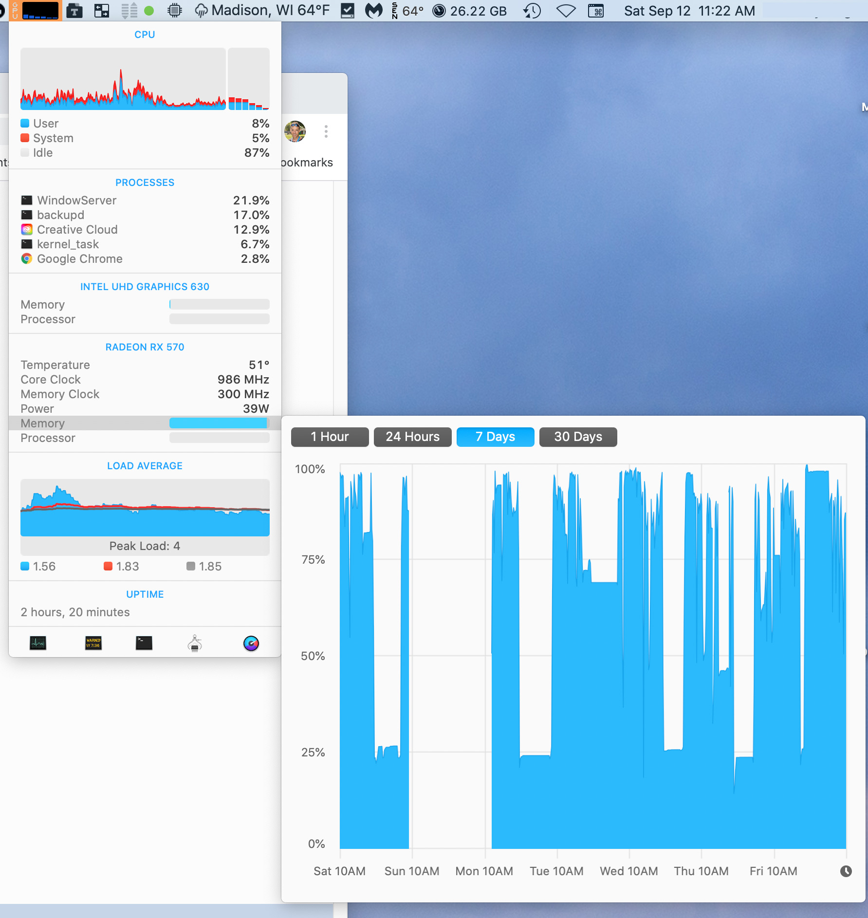

I use the iStat menus app. It's well worth the $10.
I only use two menus from the app (but there are more options): Sensors (which is the temps of everything in the Mini) and CPU & GPU. I've attached a screenshot of the CPU & GPU menu. As you can see my eGPU uses all the memory in the box (4GB VRAM) and always less than 50% of the eGPU processor. It also uses almost none of the on-board Intel UHD 630. Which is a good thing because the Mini runs cooler.
Looking at my usage, I would probably be better off with 8GB of VRAM but I got a great deal on my Sonnet puck, so it's a keeper.

Try the free XRG system monitoring utility before you spend $10 on iStat menu.
