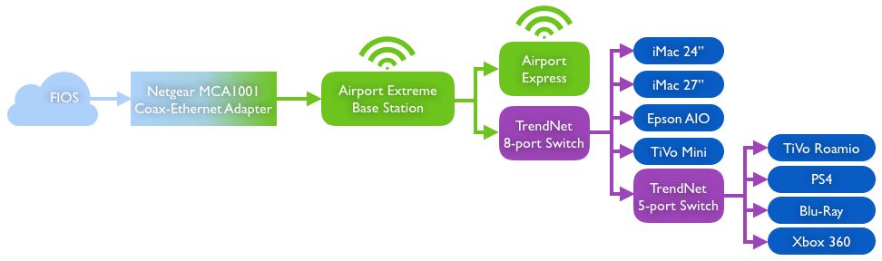

A year later, and I upgraded and reconfigured my home network based on your advice. Fortunately, a friend gave me a leftover coax-ethernet bridge that he'd previously bought specifically for FIOS use. I swapped out the FIOS router for the bridge. I reset my AEBS and it reconfigured as the root router. This enables Guest Network without issue or Double NAT.
I also bought an Airport Express and connected it directly to the AEBS; it configured to extend the wifi network via ethernet, and can also extend the guest network.
That's the final outcome. It took three full days over two weekends to get it all working with several false starts, weird problems, a tech call to Verizon to get a DHCP Lease Renewal and a frustrated wife in the midst of wasting a weekend fighting with a network that working pretty well before I started.
This is what the network looks like now. 🙂
