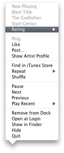

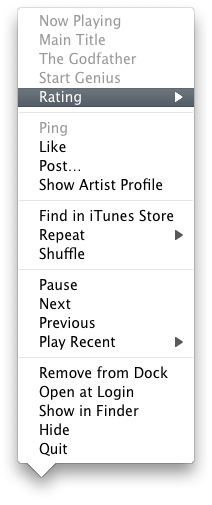

You can set the rating from the iTunes icon in the dock too.
thanks for the advice. I want to recreate natural actions, so i used the tell-orders to get to the rating item. then i closed all and faked it with your short code.
