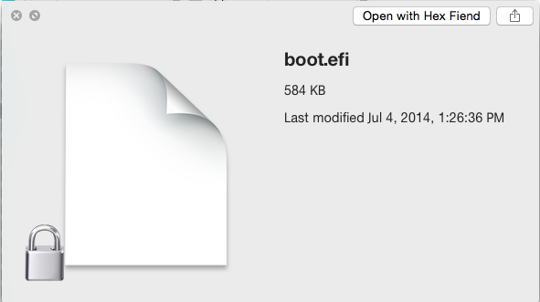

    2. Now let's back up the boot.efi file just in case. Make a folder on your desktop called "efi_backup" and copy /System/Library/CoreServices/boot.efi to that folder.
    3. Now make another folder called "new_efi" for example, drag boot.efi into that folder. Note that the icon has a lock on it:
    This means that NO user can modify the permissions or ownership of the file, not even the root user. Let's fix this so we can actually modify it.

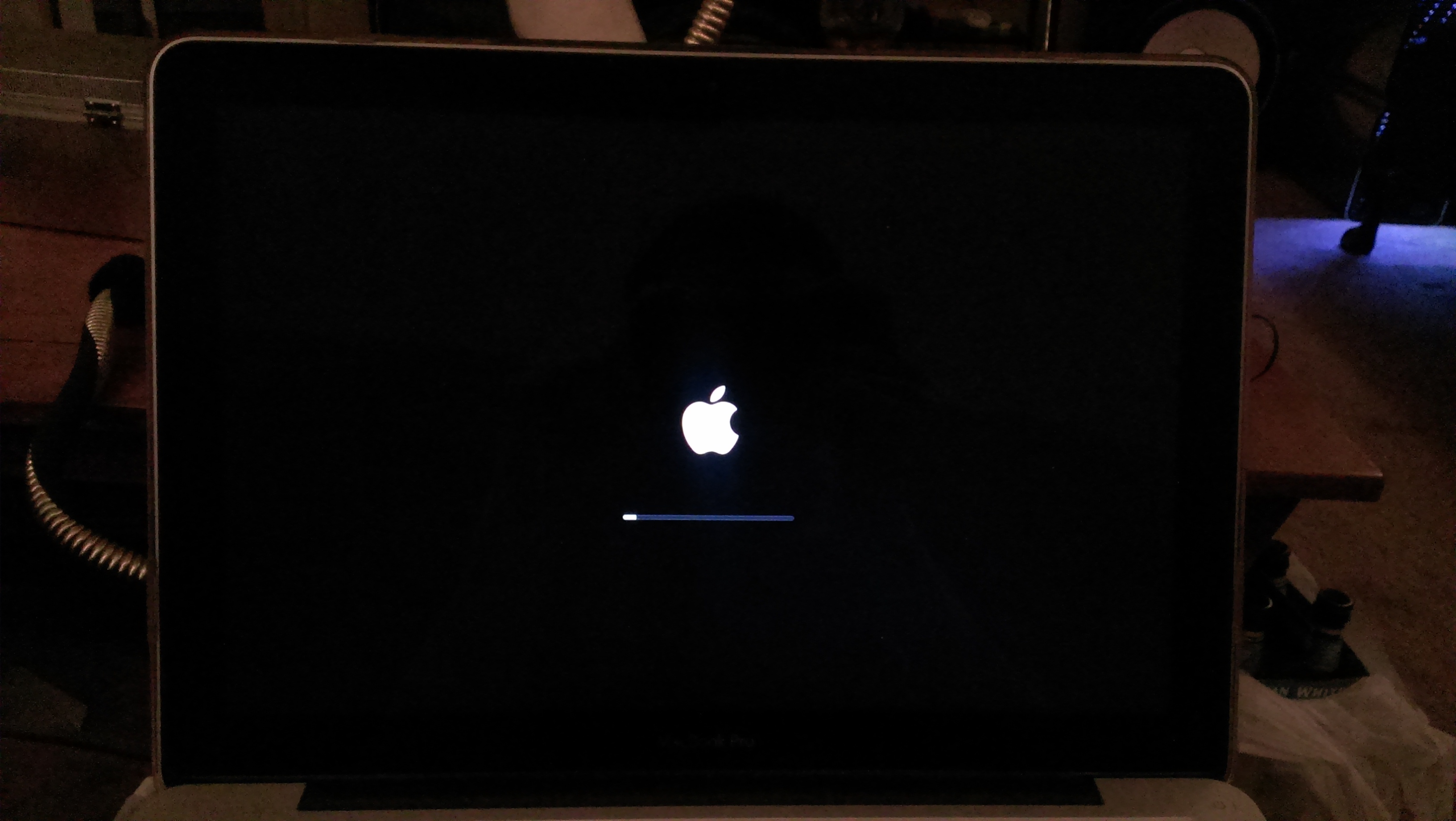

    11. Now let's reboot! You will most likely need to reboot twice for the settings to take effect.
    Here is the result:
    I'm extremely happy with this hack, I hope some of you will find it as useful as I have!
