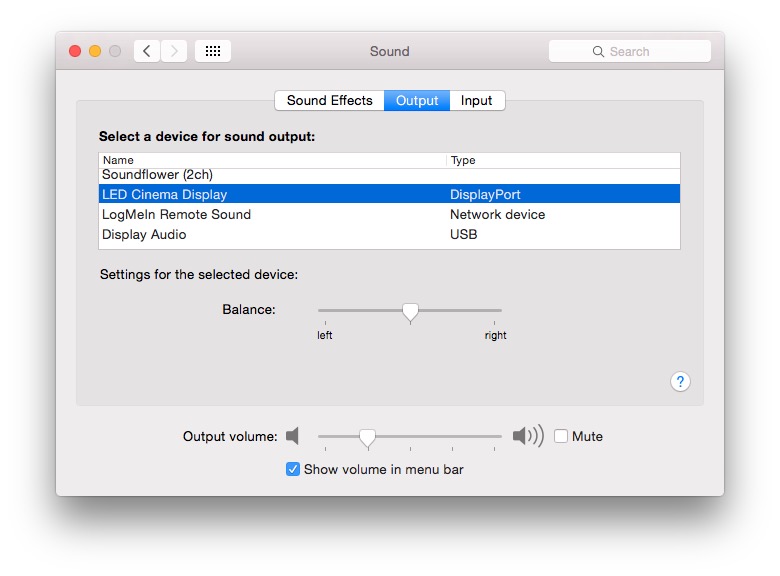

You don't really need an HDMI device to know if it's working.
I am now using the ACD, there will be an extra option (DisplayPort) in the sound preference if the driver is working properly.
Also, I would think that seeing DP output to your ACD would be unrelated to this mod. The Apple Cinema Displays accept audio input through both USB and MiniDisplayport, and will show both options so long as your card supports it. Those options have remained visible on my Mac Pro, but my HDMI connected speakers haven't been detected since I left Kepler and moved to Yosemite 🙁
Oh, I didn't realise that. From memory, I did't have the display port option until I install this HDMI audio kext in Mavericks.
Thanks for correcting me, may be I mess up something 😛
Anyway, after I install Yosemite. I didn't try to connect my 4,1 to the TV anymore. So, I am not 100% sure if the HDMI audio still working on my machine actually.
AFAIK this kext is required to have audio out through DP on a 3rd party GPU. Similarly you can also use audio out through the DVI port on the card and it is treated as an HDMI connection by OS X.

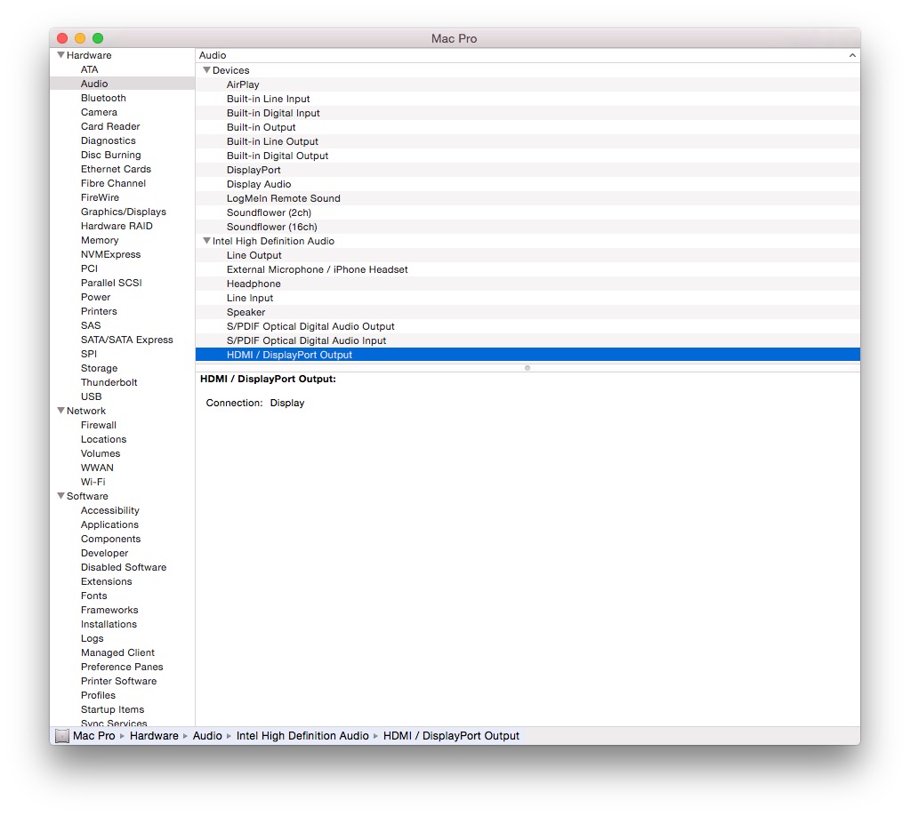

If it is working you will have HDMI reported under Audio-Devices in System Information:
