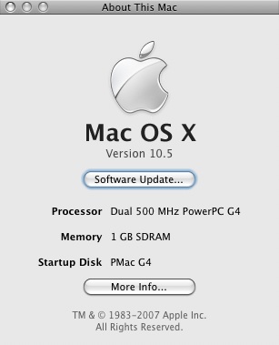

My specs are:
DP 500
1GB of RAM PC100, going to go to 1.5GB soon
Radeon 9000 Pro, 64MB, supports Quartz
40GB crappy original hard drive, going upgrade that soon.
DVD Burner 4x (SLOW!!!)
So far it seems fine. I recently got a wired mighty mouse for free, but the side buttons are so freakin sensitive, way more so than my BT mighty mouse. So I keep launching expose and it makes me frustrated!!! Other than that, which has nothing to do with Leopard it seems fine. The Time Machine backup daemon is a monster. Don't plan on doing much when that is going.
I did an archive and install. I think a full install would be better. I don't have the means to do that right now. Maybe this weekend. This also isn't the GM, so that might have an affect.
When I get the final copy next week, I will do this again and report back on the process. Overall though, I think it is great, although I can't wait to get my hands on the final build.
Good luck! If you have questions or problems, please feel free to ask. I am going to try to touch the guide up over the weekend.
