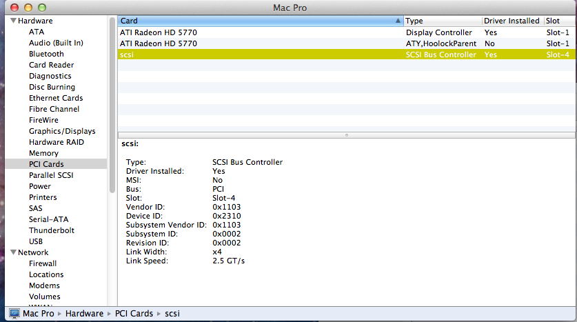

Followed the install as best I could from the PDF. Bootedup with the Chameleon startup disk, no problems, video out on my Cinema monitor OK. Selected Installer and screen went black for 25 minutes or so. I could here disk activity so I left it alone, came back and I had the Mavericks installer up on the monitor, resolution just fine. Rebooted and Chameleon starts up no problem. Selected Mavericks partition and screen goes black again. In 10 minutes or so I hear the speaker say "press return for english" so I press return. Let it run, screen still black. Again the speaker tells me about voiceover options but no video. After another 30 minutes I hear no disk activity so I gave up and rebooted back to Lion.
Here's what the video PCI card shows in the detailed report. It shows two Radion 5770 cards one with a driver installed and the other without. The other "scsi" card is a two port eSata card for external drives. I am not using these external drives for this installation. Any thoughts on video and lack thereof?

@Hennesie2000
What is GraphicsEnabler set to in your org.chameleon.Boot.plist? And just for clarity is this a stock 5770, PC card or flashed?
Stock card as far as I can tell, not reflashed. Card displays boot screens normally whereas from what I gather the reflashed cards do not. As far as what the org.chameleon.Boot.plist graphics enabler setting I have no idea. I used the default stuff from the "Chameleon Bundle" download. What value should I be looking for specifically??
PC cards that have been EFI flashed will display an Apple logo at boot just like the stock cards, it is the non-flashed PC cards that result in a black screen until desktop. At the time you took that screenshot were you running Lion normally or booted via Chameleon? If you bought your 5770 second hand then you're most certainly running a flashed 5770. The entry with the missing driver indicates HDMI audio.
