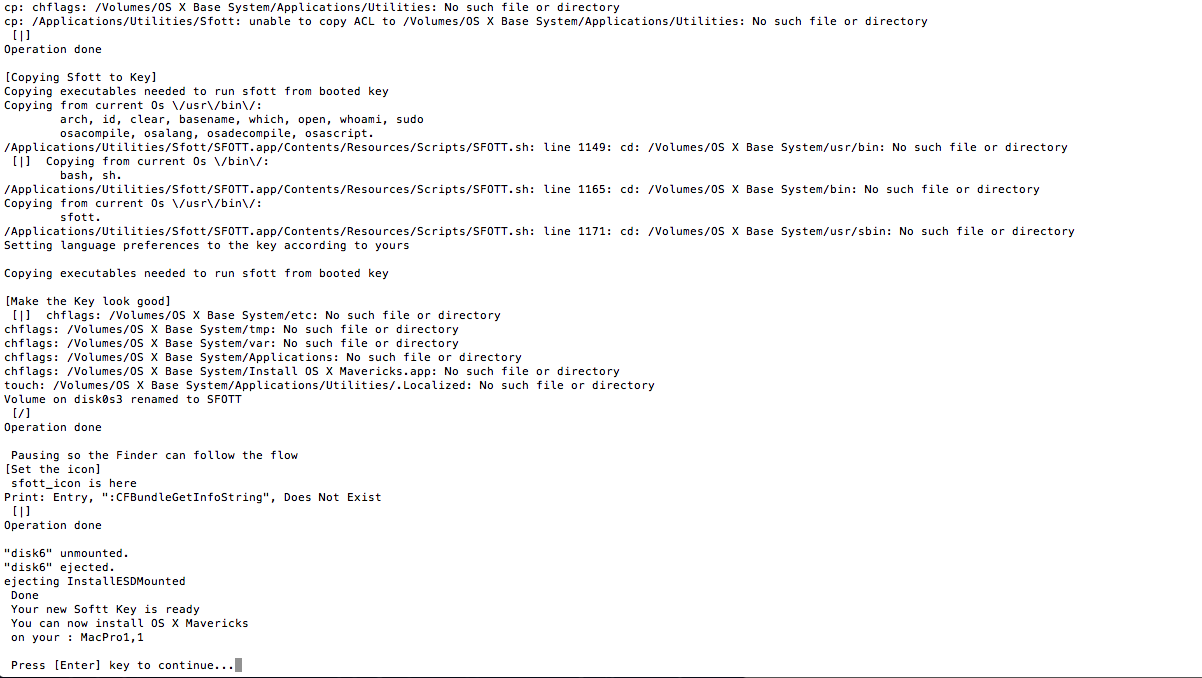

having troubs getting this installed on my MP1,1...
everything goes great. downloaded the 10.9 installer straight from Apple. on a MacPro1,1 and tried both USB key and a 10GB partition on a spare internal drive. it appears as though it gets created fine using SFOTT (meaning everything 'looks' correct on the USB key/partition) but when i try to hold 'Option' down on restart or even select it as the startup volume - it defaults back to the last OS that works that i am using (10.7.5). instructions were followed multiple times very carefully.
looking at the log everything looks like it is being created properly via SFOTTs 'auto run' until it hits here:
i could use some help from you ninjas out there please and TIA.
What I see: the Path /Volumes/OS X Base System/ contains Spaces and they're not included in Apostrophes or have Backslashes. Or the given Path is simply wrong. Therefore the error: "No such file or directory".
It must look like: '/Volumes/OS X Base System/' or /Volumes/OS\ X\ Base\ System/ .
Google after: "OS X Filenames with Spaces". Check also, if the given Path is correct.
I had the same issue. I aborted an installation with ctrl+c once but the volume OSX Base System never properly unmounted, the new ones that show on the desktop are actually "OSX Base System 1" but you don't see the 1. Go into your HD and into /Volumes & delete/unmount the OSX Base System folder (Should have a red "Do Not Enter" icon thing on it). That solved it for me.
that worked for me (kinda)!
i just ended up erasing the whole drive and reinstalling 10.7.5 from scratch and doing everything else from scratch. i believe the problem started because i had run SFOTT but didn't have the 'Install OS X Mavericks' in the applications - just the ESD basically. so SFOTT created all these folders all over the place and i couldn't find them to get rid of them so i just started over. worked like a CHARM.
