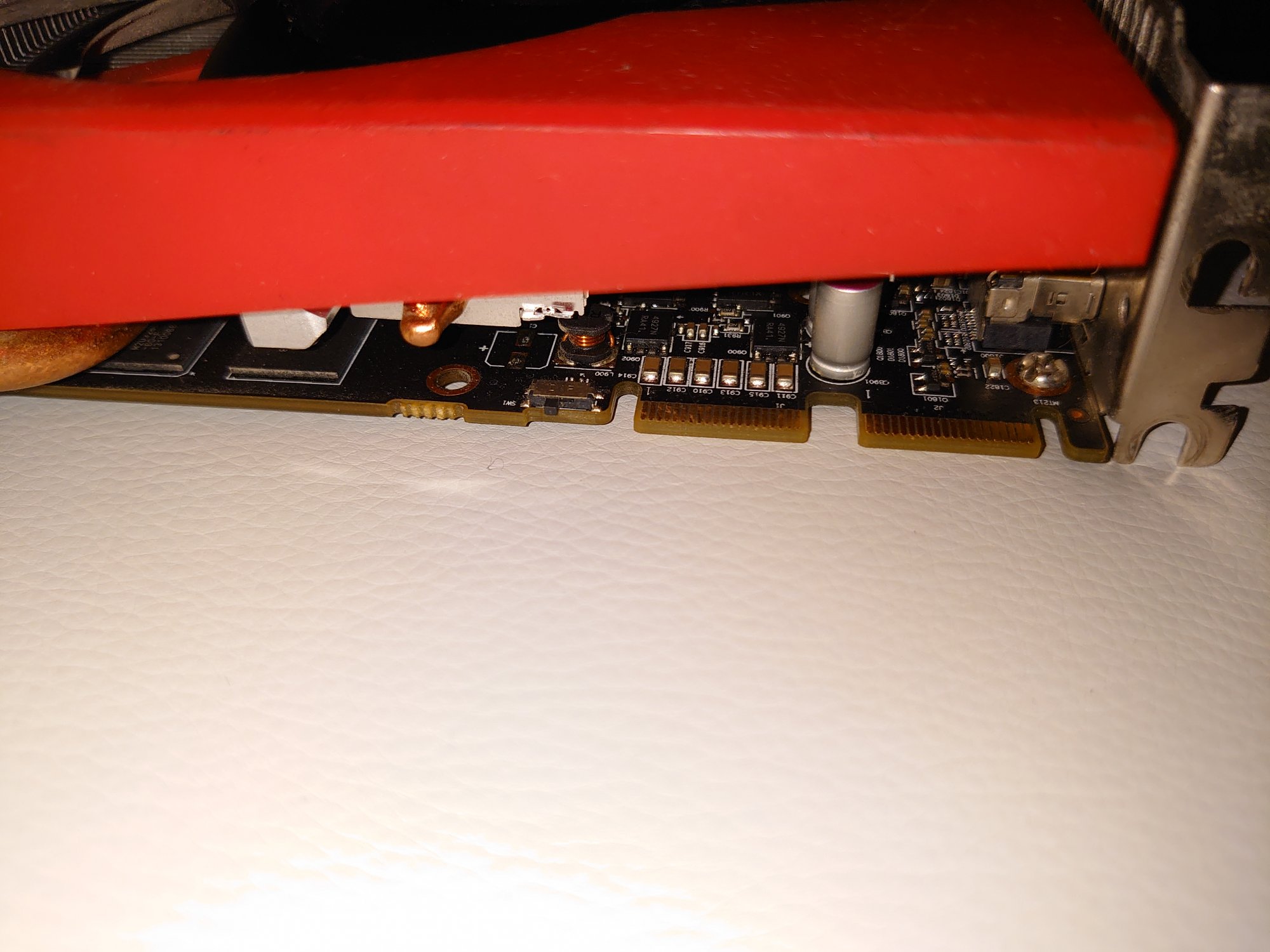

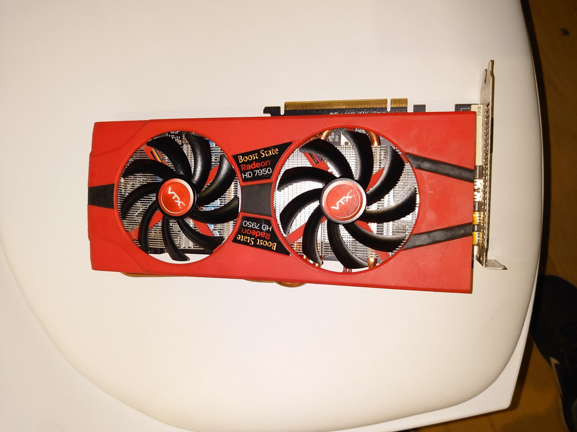

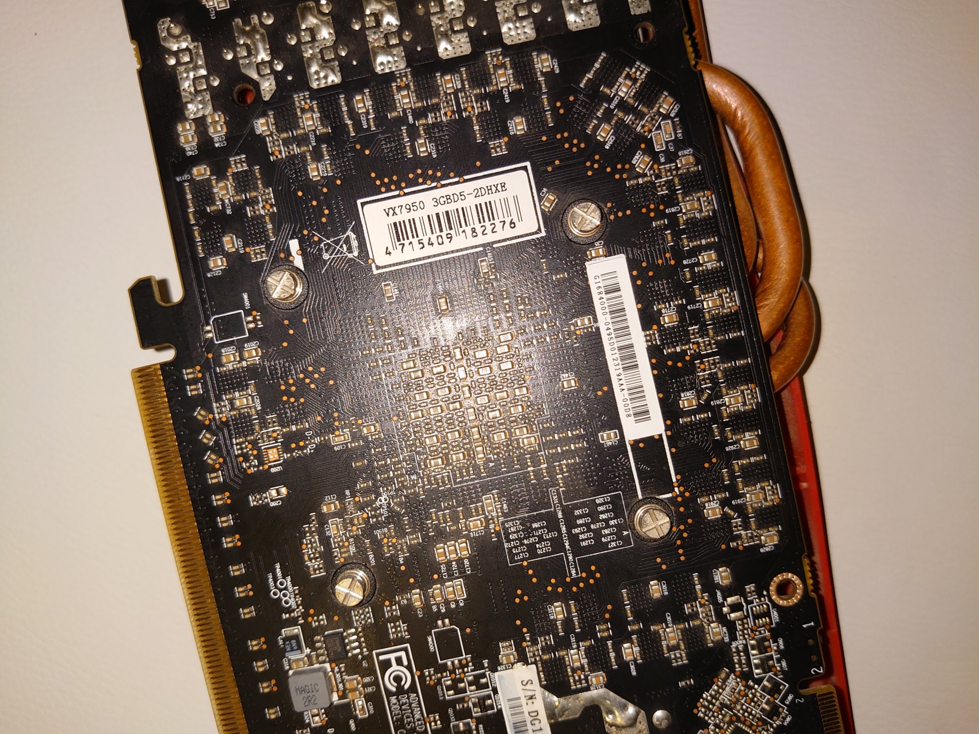

Ok, so I´m trying to flash a VTX Radeon HD 7950, and however following all the steps, seems to be missing something.
Did anyone flashed one of these?
The mistake I think I´m doing, it´s that after I run the script in the OSX, I don´t change anything, and go into a windows PC and flash the efi rom file. How you guys edit the file before flash?
Anyway, if anyone had a rom file that had worked on one of these, would save me a "ton" of work, because I don´t use bootcamp, I just use another PC with Windows 10.
Thank you

Today I retried the whole process, flashed it. But still nothing.
I attach the original and patched ROM.
Anyone can give me a help?
If someone has access to a mac and could run the script for me, I'd really appreciate it.

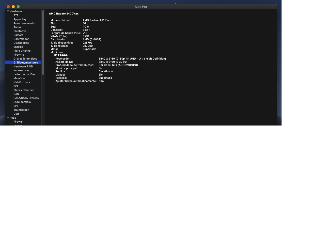

EDIT: Added a screenshot by System Profiler
