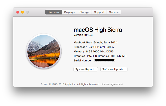

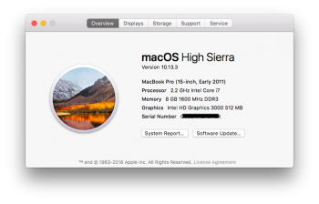

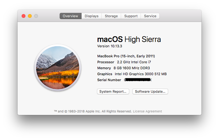

Anyway, I hackintoshed my Dell E6520 Laptop(Core i7,8gb,NVS4200m(Intel HD 3000 IGP is what Im using tho)) Took me all night since I was missing some obvious steps to follow but turned out great!. Heres the About my "Mac":
While the serial probably doesn't matter to block out for a hackintosh, I just prefer to.
I have a Mini PCIE to A1466 BCM94360CS2 on the way so I can get native support for Handoff,Airdrop,Unlocking my hackintosh with my AW and so on.
http://forum.osxlatitude.com/index....precision-vostro-xps-clover-guide/#entry54621
This was the guide I followed incase any users with the same Dell come along(or similar) and have some motivation to hackintosh. There were some new things that I hadn't done while hackintoshing before so the experience was a little confusing but eventually I figured everything out.
