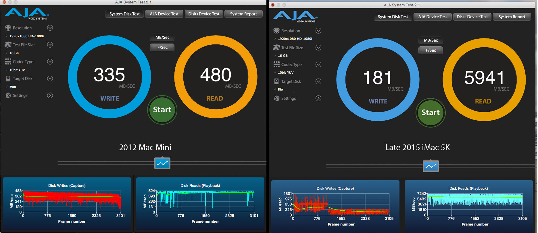

I ended up installing el captain over my Superduper backup, which gave me back my recovery disk and also seemed to fix a few little quirks. I have a 2012 mac mini with a fusion drive at work and ran AJA System test 2.1 on the mini and my iMac with my recreated fusion drive. With a 16GB test file the iMac starts out faster but about 1/4 of the way through it slows down. The read speed is very fast. The mac mini stays constant through out the entire test. I not sure what this means. So if anyone has some insights I would appreciate it
Anyone with a late 2015 5K iMac with a 2 TB fusion drive care to post a benchmark with AJA System test 2.1 showing the graph. I would appreciate it. I just want to see if the fusion drive I created is working as good as the factory setup. It feels good to me but I just want to check.
Thanks

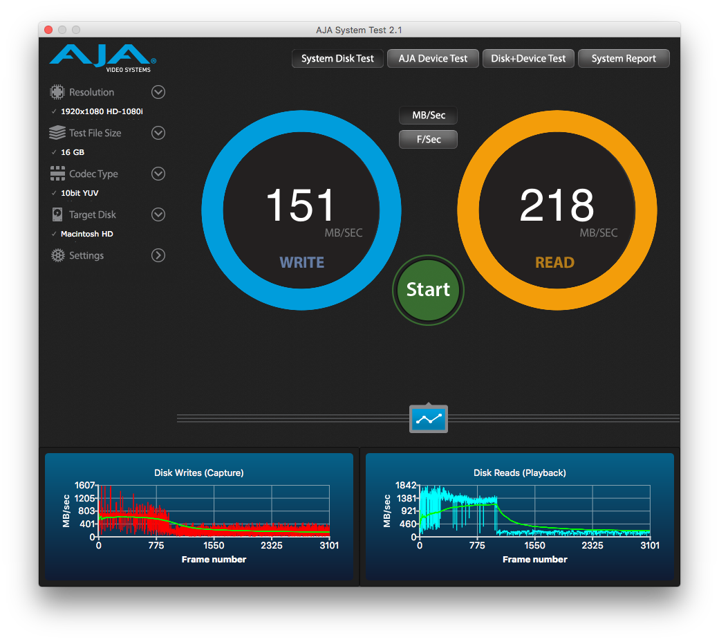

Here's what I have, the results seem a bit slower then yours.
I guess I can attribute the write speed difference because you ran yours off a freshly formatted computer and I have one that may be a bit more fragmented - I don't know to be sure.
As for the read speeds, I have no idea. I ran this twice and the results were about the same.
My iMac - M395 2015 iMac with 2TB Fusion drive and 8GB of ram.
