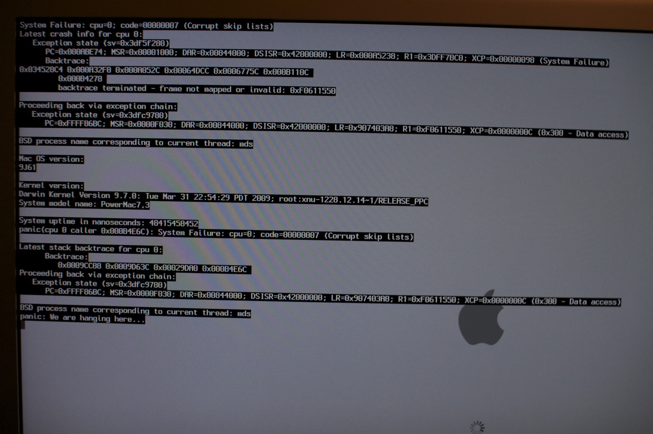

My powermac g5 is just over 5 years old. It's been working great up till about half an hour ago. Here are the pictures of what it does when it boots up, can anybody read into this?
here is what i do know:
Boots into firewire mode - HDDs still work
Graphics card still works
What I don't know:
dead memory?
dead motherboard?
dead cpu?
I'm hoping it's the memory... but how do I test for this?
any insight would be appreciated!!

From the panic message -
System Model Name: PowerMac 7,3
Edit- D'OH!
OP, unplug everything but the keyboard and try booting. Same thing happens, then the problem is probably a bad stick of RAM, so you may want to remove RAM pairs until it boots correctly - only one stick in a pair has to be bad. Process of elimination.

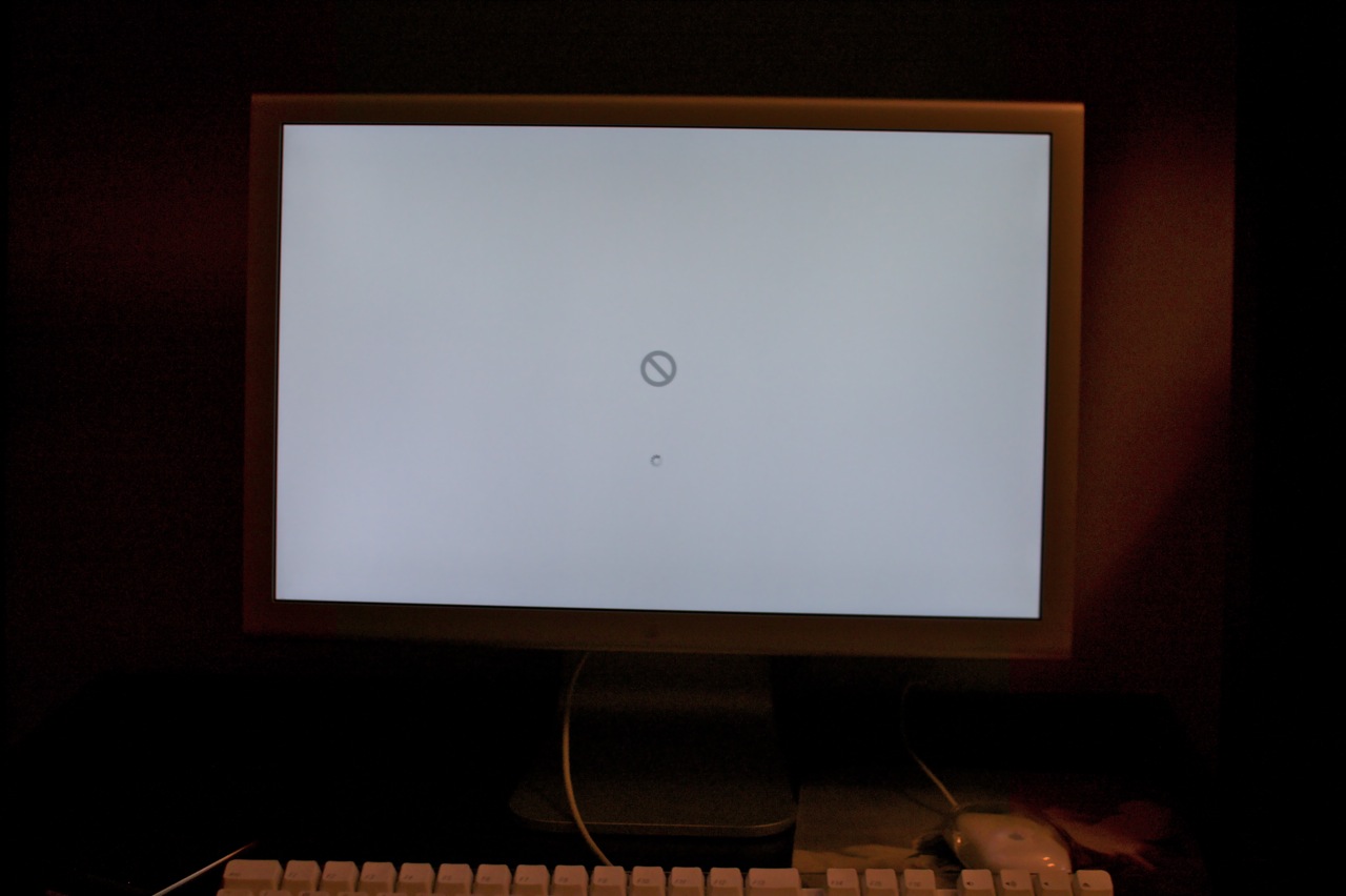

I tried booting it up with just the 2 factory ram sticks alone, and also with the 2 kingston ram sticks alone. Both times it would give the bootup chime, show the apple logo and spinning thing for a minute, then go to the cross.

So I detached the harddrives and tried booting up from the firewire image again - this time it didnt boot and would give me the cross.

I've taken out the harddrives and have just been trying to boot off a firewire image of the osx install, it will not boot up (still goes to that cross). I'm trying to decide how much more time its worth trouble shooting. I've been wanting to upgrade to the intels, so now i have a reason to.
