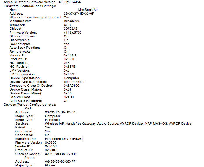

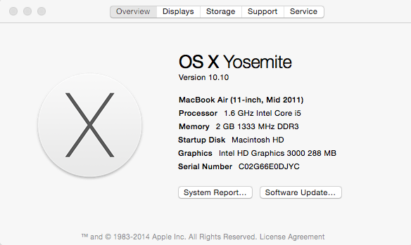

Macbook Air Mid 2011
I've scoured the internet and boards to see why my Macbook Mid 2011 doesn't have the Handoff feature and could really use some help. From what I've read most people with Mid 2011 airs are at least able to see the option to enable Handoff in Settings > General but mine doesn't even have that feature. I've followed everything that I could get my hands on and followed the instructions verbatim here, as well as other sources. Would anyone know why I wouldn't have the option to toggle Handoff in settings?
I uploaded two screenshots for specifics but any help would be GREATLY appreciated!!
