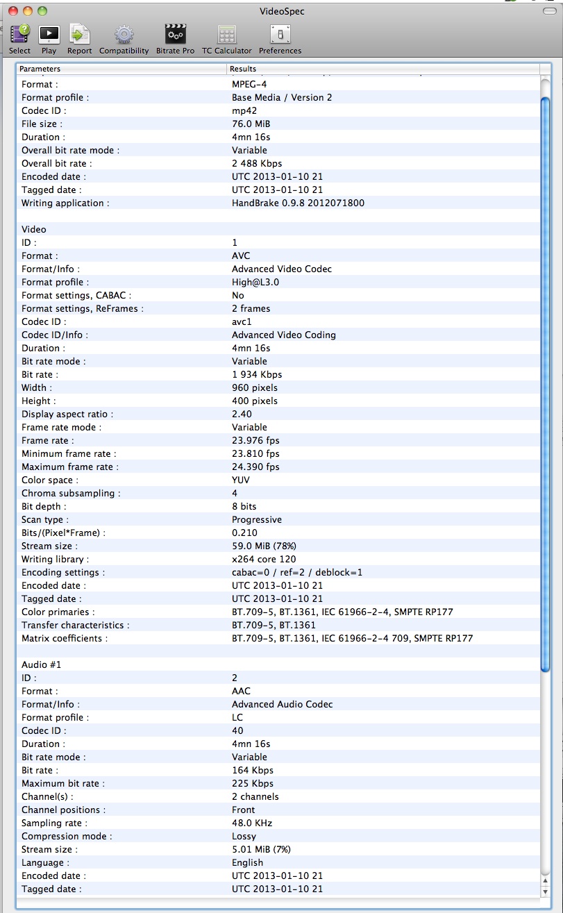

i am trying to encode a video file that has 5.1 audio For my Apple TV first generation and i have the audio set to dolby pro logic ii from an apply tv preset but when i check the file with a program called videospec it shows up as 2ch stereo. what am i doing wrong? isnt dolby pr logic ii actually 5.1 surround sound? Should I set it to six channel discrete? any help would be appreciated. Thank you in advance.

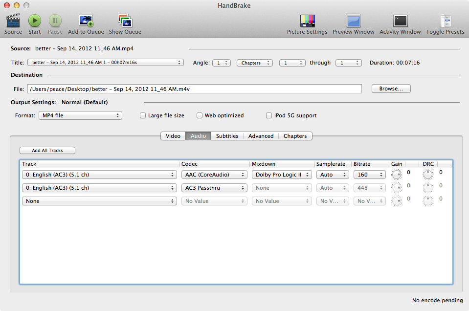

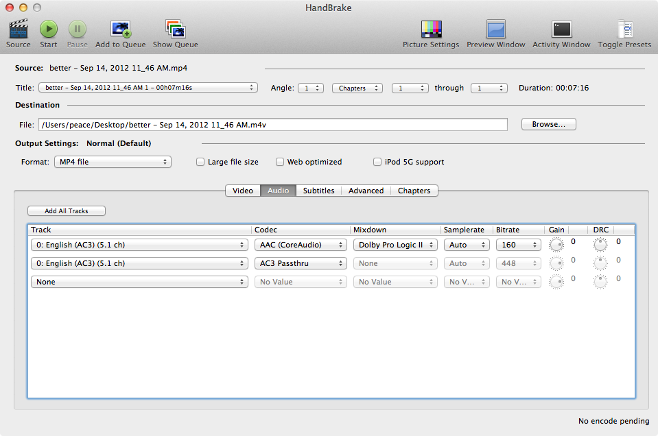

You need to make two audio output settings.
The second one should be AC-3 passthrough for the 5.1 audio.
Pro Logic is not true 5.1
You need to have an AC3 (Dolby Digital) track to have true discrete surround sound and a receiver that can decode it after the ATV passes it through.
Dolby pro logic is not true surround sound, it is faux surround. It is a set of audio algorithms that help receivers decode stereo sound and make it into surround sound. If you want true surround sound you need an AC3 (ffmpeg) track selected as 6-channel discrete. The Apple TV 3 preset will automatically make both tracks.

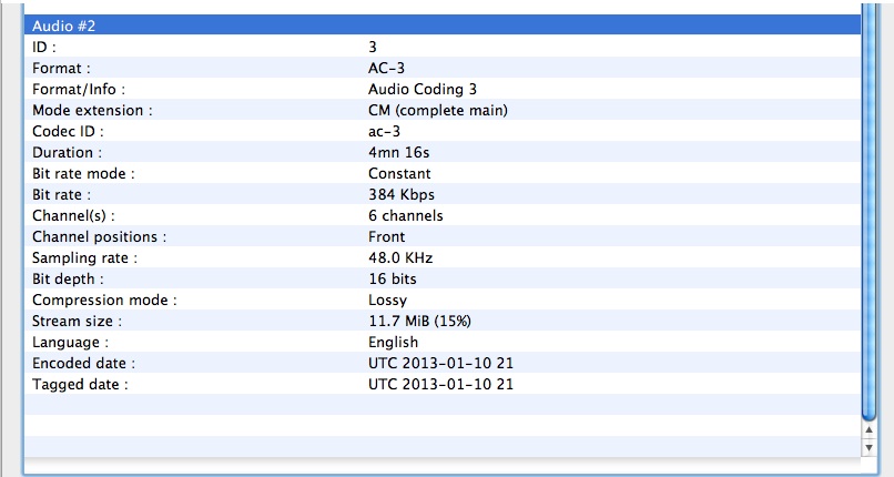

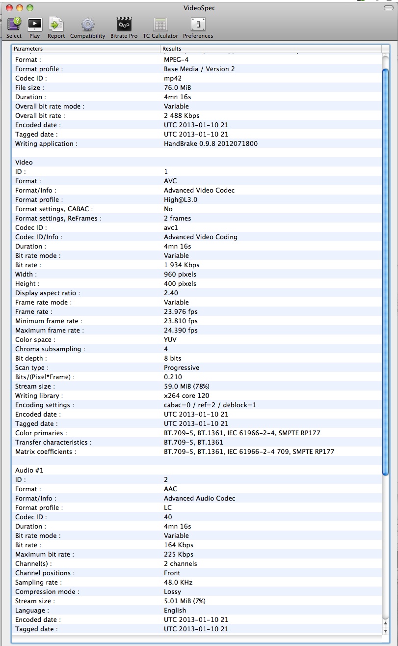

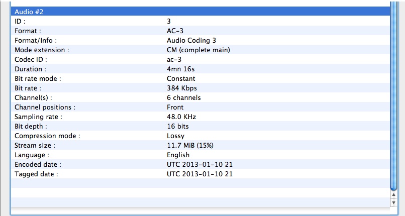

I did take a look at my program videospec and I figured out why it keeps saying two channel stereo. It only tells you the first channel in the basic mode. Plus I'm assuming because I'm playing it on my iMac which only has stereo that's the channel that is selected. I changed the view of the program and it shows you both channels. Dumb mistake on my part. Anyway the second channel is showing up as six channels ac3. So which will Apple TV?

OP: You're not doing anything wrong. Dolby ProLogic is not a discrete 6 channel format. It's a two channel format, and other external programs will only ever recognize it as such.
To be a little more technical, Dolby ProLogic II is not really a format so much as it's a decoding method designed for Dolby Surround. But I won't bother you with the extremely technical details unless you really want to know.
The default behavior of Handbrake is that it'll create an AC-3 track and an AAC track that's ProLogic compatible. This is a bit of handwaving since the Handbrake encoder doesn't actually downmix anything... the Dolby Surround mix already exists in the front left and front right channels of any program that has a Dolby Digital track, and a ProLogic/ProLogic II decoder decodes the matrixed surround out of those two channels. How it does it is a longer, more boring discussion.... but no format analyzer will really recognize it as anything but stereo because digitally speaking there are only two channels.
If your version of handbrake presets isn't automatically selecting "ProLogic II downmix" in the audio settings, change those settings to show what that guy above, Peace, had taken a screenshot of.
