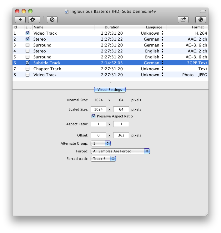

Not sure if this is the issue or not as handbrake usually does it correctly with the ATV presets but the AAC track needs to be the default audio track. I use subler to do this which is mac only. If you have access to a mac use subler to open the file. Make sure AAC track is checked and AC3 track is unchecked. Then save and retry playing with TV and receiver. Not sure what the windows equivalent is. Looks like xmedia recode does similar things but don't know if you can change default audio track. Will need windows users to chime in here.

I believe the AAC track needs to be enabled (checkmark in Subler), and AC-3 track needs to be disabled (checkmark cleared).
Thanks for the visual of Subler. If I uncheck AC-3 and just keep AAC then won't the AC-3 track be unavailable to play through my surround system?
While it's not necessarily intuitive, all tracks present can still play, checked or not. The checks seem to indicate which is default. You can actually check more than one which doesn't make sense to me though and doesn't work at least with atv.
