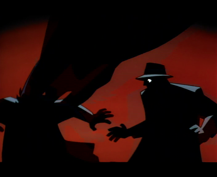

can anyone help me improve encoding Batman TAS? i've set Decomb and Detelecine to default, and it improves the video almost perfectly. the source is hard telecine. the encoded result almost completely removes it resembling the progressive look (that I'm especially familiar with on the PAL UK release of these volume sets) but I'm using the american ones (because they were released complete) and I'm still getting instances of this:
it happens every now n then during more high speed motion, its sort of distracting and unsatisfying given that I'm familiar with the content without this.

i'll get back to you on that one, i believe it probably does. it happens in all parts of the video every few moments, it is like this on the disc (the file is like this from the MKV) when i encode with Handbrake with default decomb/detelecine on, it improves greatly and most of it is gone. i wish i just could get the remaining splices here and there.

it shows on the DVD in playback. and yep its in the original make MKV file, but its constant in the MKV file, after default deteleine/decomb it removes it almost completely, its only in more high motion scenes (like moving smoke, or this fight sequence) that it shows itself.

i just installed the newest handbrake (but kept the old one as well) and tried the same settings but added a lot of 9's in the custom value for detelecine, and the result is much better! there is still evidence of that frame but the lines have gone! much less distracting. i'm going to test the same setting on the older handbrake to judge if its the setting or the newer handbrake.
edit**
it looks like its the new handbrake that deals with it better. thanks for the help HobeSoundDarryl, without your input i probably wouldn't have got to where i have!
