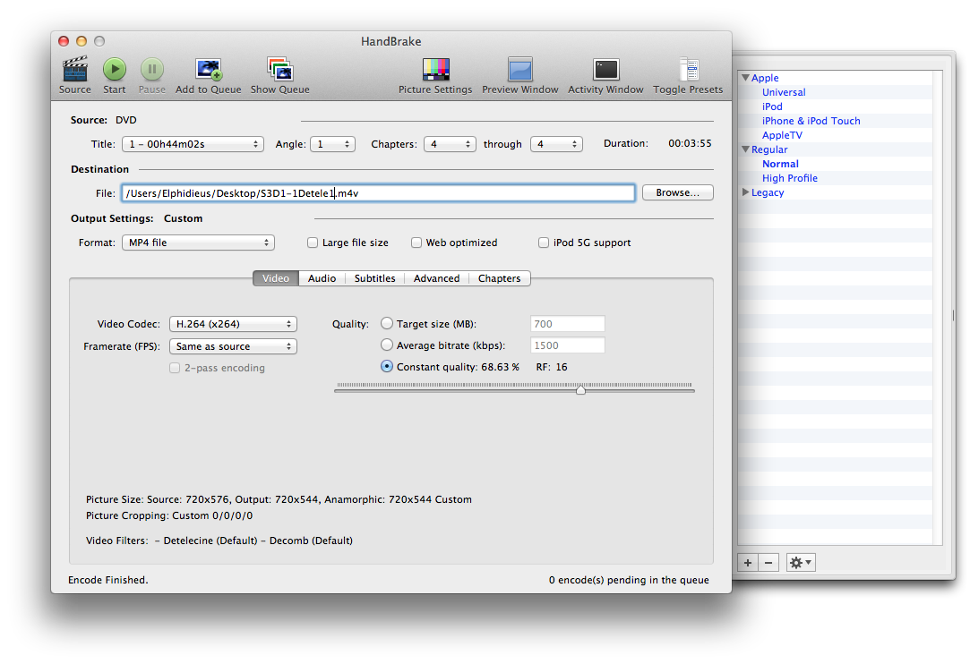

Hi guys,

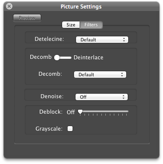

I'm trying to convert my Star Trek Voyager Region 2 DVDs, but having problem with stutters sort of like frame drop on certain scenes when setting Detelecine and Decomb to Default. If Detelecine is turned off and Decomb remains Default, the judder disappears, frame rate is smooth, however bits and pieces of interlaced frames can been seen.
I can set Deinterlace as Default instead of Decomb, but it reduces the video quality greatly. Any ideas...?
For the record, I also have ripped Star Trek Deep Space Nine DVDs under Region 1, but have never encountered such issue.

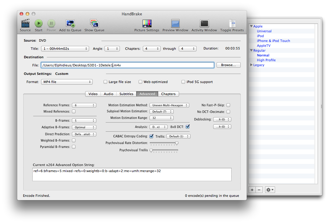

Below are screenshots of my settings. Any inputs will be greatly appreciated...

Are you in Region 1 and this is the first Region 2 DVD's you have ripped? If so you may be having PAL problems. PAL DVD's are 25fps while NTSC DVD's are 30fps.
I'm in Region 3 and I've got a whole bunch of Region 1 DVDs ripped without issue.
Just happened this set of DVDs are from Region 2, and I've tried setting it to rip at 25fps PAL instead of "Same as source", but no difference, still having that stuttering issue. I'm also getting mild stuttering on certain scenes with Detelecine Off and Deinterlace set to "Slower". Seems like a source problem with interlacing.
Ripping my DVDs mainly to watch from my MBP, nowhere else...

Detelecine assumes a 24fps end file. Using it on PAL DVD will cause issues as it runs at 25fps.

Same as source is what you want unless your playback device has a fps cap (appletv etc.) though that would not apply to either ntsc or pal dvds.
