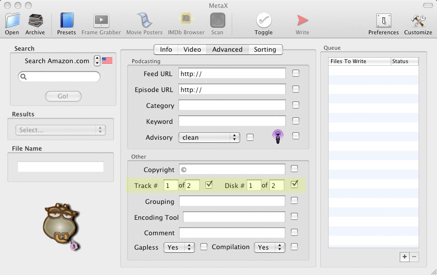

Yes - but use 1 and 2 (see image capture) under the Advanced tab there are track and disk fields - use these and the AppleTV will see the files as one.

Yep - as long as they are all tagged with the same name and the appropriate track and disk numbers it will show and play as one. I have done this with all my LOTR titles and a lot of concerts that are on more than one disk - works great 🙂

I just tried this and it didn't seem to work. I made sure to tag them with the same name just change title/disk 1 of 2 and 2 of 2 but both show up on the :apple:TV now.

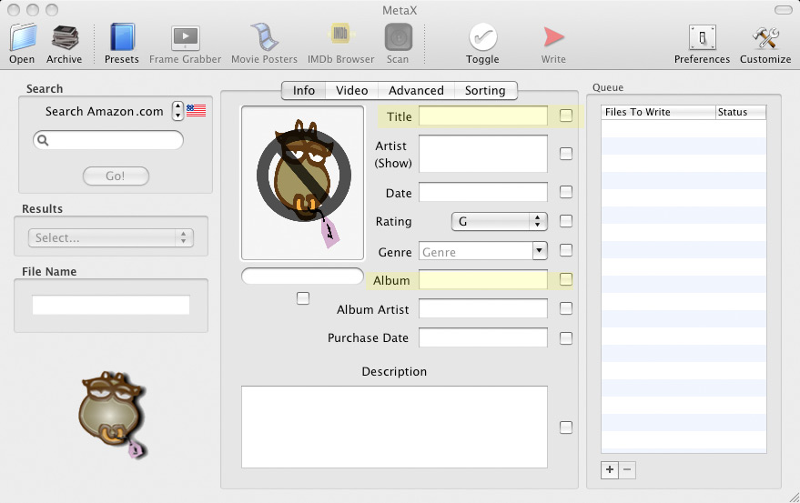

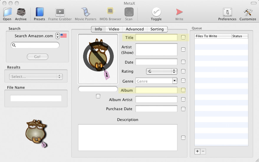

Try labeling the Album the same name too... (I have both done on mine as well, forgot to mention that...) The Title and Album names must be the exact same on all the files.

I've tried this and it doesn't seem to be working. Not sure if I'm doing something wrong.
Can you do a screen grab of both windows? (Info and Advanced) {Im at work and don't have access to my files unfortunately - Ill double check the settings when I get home}
The title and album name are exactly the same.
Okay Im home now and have it figured out (that will teach me - trying to answer questions while having the Flu for a week is not a good idea! LOL).
Make sure you have all the titles marked as part of a Compilation on the advanced panel in MetaX as well (you can do that through iTunes as well).
I just tried and it worked for me... so if your still having problems let me know. Sorry I missed that last thing... gotta drink more airborne 🙂
