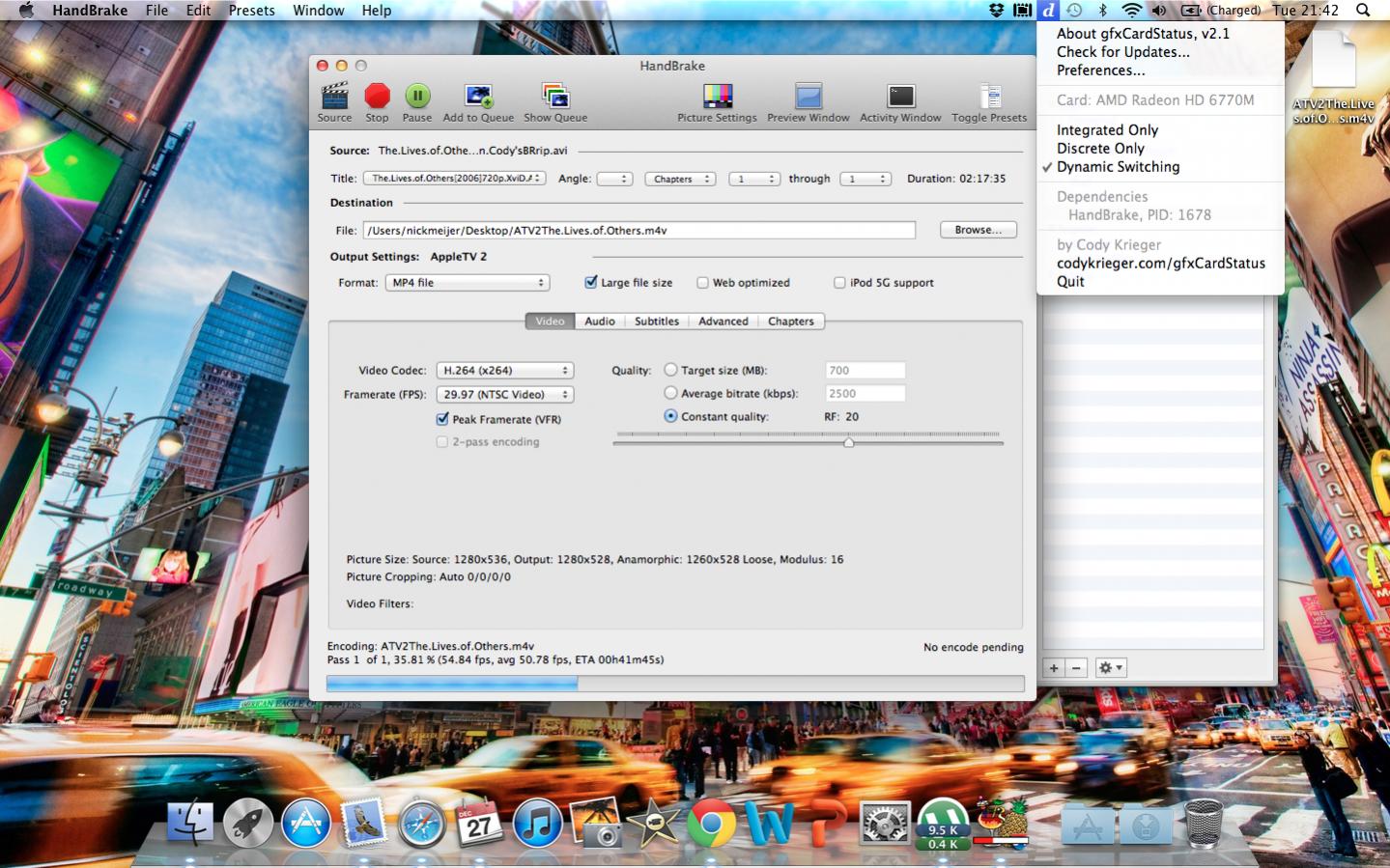

Hi guys,
According to the developers' own FAQ, HandBrake should not utilize any of the GPU's processing abilities at all. However, when converting a film to be watched on my Apple TV2, HandBrake is forcing the dedicated GPU to turn on, thereby increasing the heat and noise output of the machine. If HandBrake does not require any of the GPU's capabilities, why does it force it anyway? Screenshot and MBP specs below.

I doubt it makes a difference as far as heat and noise are concerned. You could force the integrated GPU and see if it makes a difference. As long as there is no load on the GPU, it will not generate a notable amount of heat.
As to why it activates the dedicated GPU, I don't know. In the end it is OSX that decides which GPU to use, but I don't understand how it makes this decision.

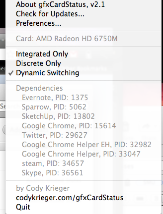

Random programs call API's in the OSX system that cause it to turn the dedicated GPU on. many programs do it that don't need it (see picture: )
Basically, if you don't want the dedicated GPU on, force integrated. Just about everything works fine w/ just the integrated (i only turn it on for gaming).

You're right. I just checked the idle-idle test, I forced the dedicated GPU while browsing. Power consumption goes up by some 5 W, and the CPU temperature also increased by about 5C.
Under load this should be different. If the GPU remains idle, while the CPU is fully loaded, the temperature difference should be small, but maybe still measurable. In that case usually the CPU heats up the GPU through the heatsink. Finally, when both are under load, I guess the CPU temp will be a bit higher again, due to the shared heatsink, as you pointed out.

In my totally unscientific and probably immensely subjective little research, I've established that:
1. Under heavy CPU load, with the dedicated GPU turned on, fan speed remains at 6200RPM.
2. Under heavy CPU load, with the dedicated GPU turned off, fan speed turns up to 6200RPM, then slowly decreases to a stable ~5000RPM.
I think I can therefore conclude that the sustained higher RPM in case 1 means that the computer has to deal with an increased heat output produced by the CPU and GPU as opposed to case 2. This is all tested with a HandBrake conversion and forcing the GPU on/off with gfxCardStatus.
I'll set gfxCardStatus to integrated only for the time being. I will manually turn the dedicated GPU on when needed, since the decisions the software is making seems to be rather unreliable.
Thanks for the help guys. :)
I keep my dGPU turned off 95% of the time, i tell gfxCardStatus to stay in iGPU. I have ripped numerous DVD's using handbrake in iGPU and not seen any issues while ripping or playing the encoded movie.
It is not handbrake that turns the GPU on. OSX is does it when APIs that make use of the GPU are in use by the app.
It is not a perfect system. Use GFXCardStatus to manually turn the discrete GPU on and off.
That's what most of us do. However, I take issue with the term "unreliable." IMHO it's completely reliable. When a program calls an API that OSX tags to turn on the dGPU, that GPU turns on. it's done on the "err on the side of safety" method, probably, to make sure there's always enough power to run what the user needs.
