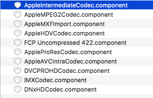

You can check /Library/Quicktime/ to check which Quicktime components are installed. In my case I have:
Applelntermediatecodec.component
AppleMPEG2Codec.component
AppleMXFIimport.component
AppleHDVCodec.component
FCP Uncompressed 422.component
AppleProResCodec.component
AppleAVClntraCodec.component
DVCPROHDCodec .component
IMXCodec.component
DNxHDCodec.component
