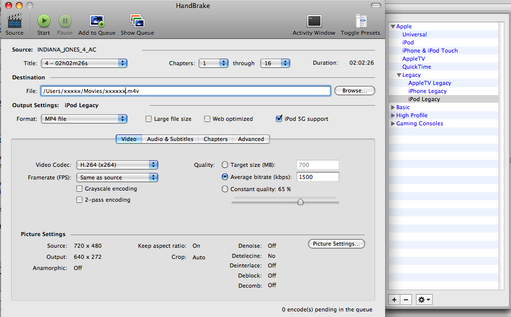

I use Apple > Legacy > iPod Legacy
Attached is a screen shot of my setup. I have no problem using this setting in iTunes, etc.
