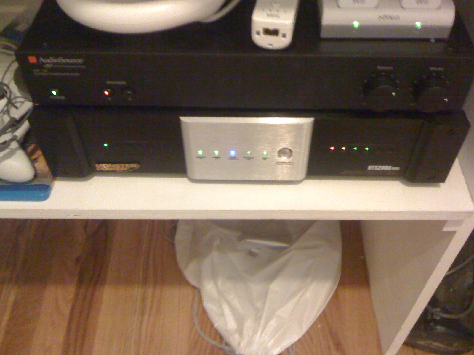

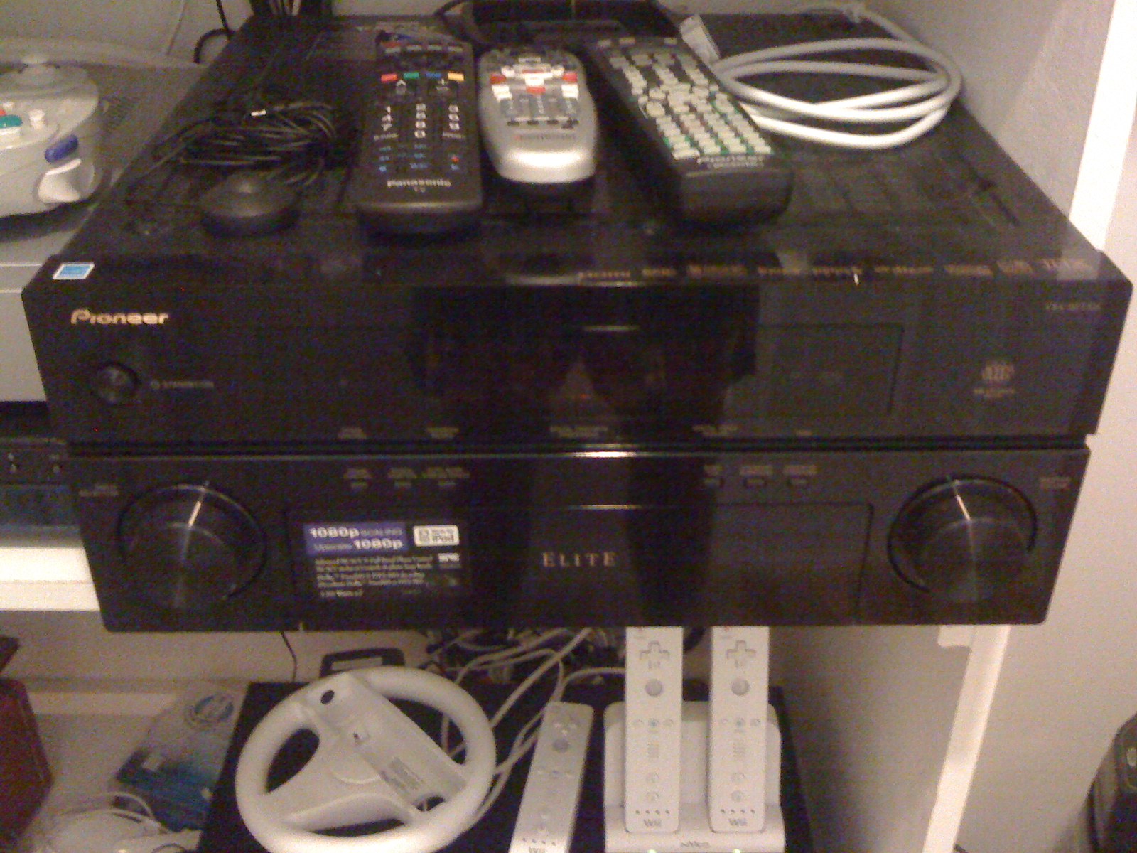

Heres two pics, I assume the first one has something to do with video and the second has to do with audio.

Okay well try this - using a source were audio does play - turn on your TV and the receiver. Turn the volume down to nothing on your receiver. Now turn the volume up on the TV - do you hear anything?
Simplest way is to figure out what indicator on your receiver signifies Dolby Digital surround which is usually a red DD light or like on an onkyo will say Dolby D.
Anyway, then with your receiver and everything on reboot your atv. That intro movie that plays at the beginning when it boots is in ac3 5.1 surround (where do you think we got the format for handbrake 😉 ) Anyway, if that intro movie lights up your Dolby D surround sound indicator then your HandBrake encoded ATV preset movie will as well. If not, then there is an issue with your system. Note: do not confuse a Dolby Pro Logic or some such indicator with the Dolby 5.1 surround sound indicator.
