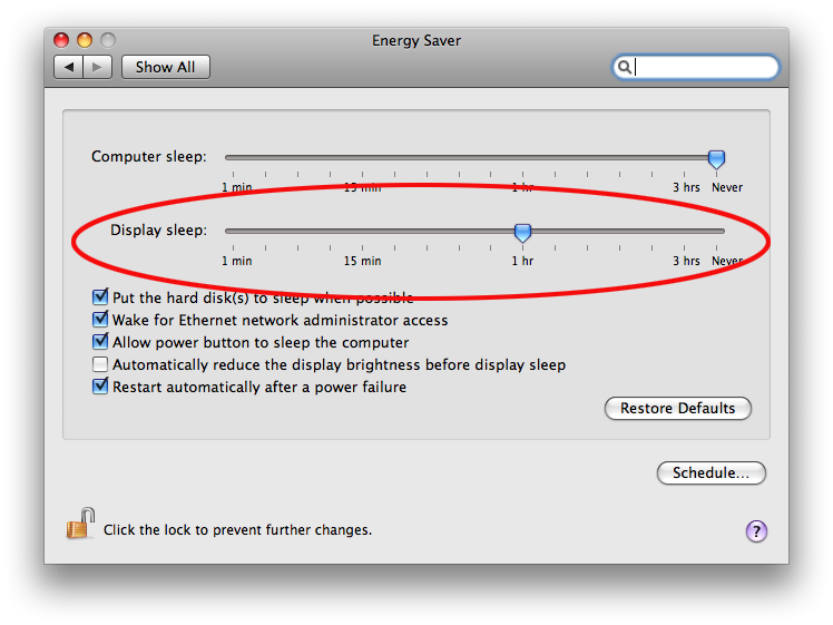

Check your System Preferences -> Energy:
Se if the screen sleeps after a certain time of inactivity (DVD ripping is inactivity, as far as the screen is concerned 😉.)

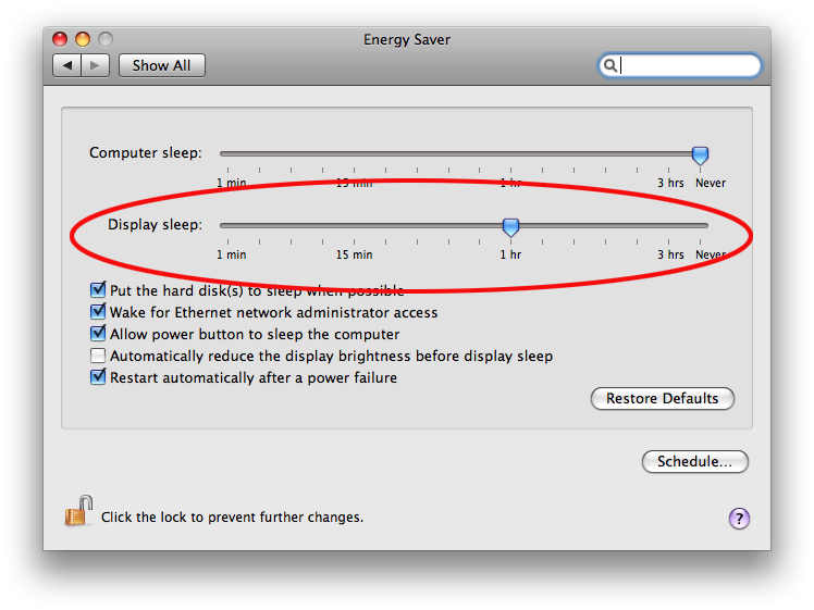

I am not so sure what u mean but if i remember not wrong. It happen before as well during handbrake. I click command+I try to check the infor of the file that still encode, and other file as well. It turn black and i can only see the mouse pointer. i close the lid and open again then i can see the screen
