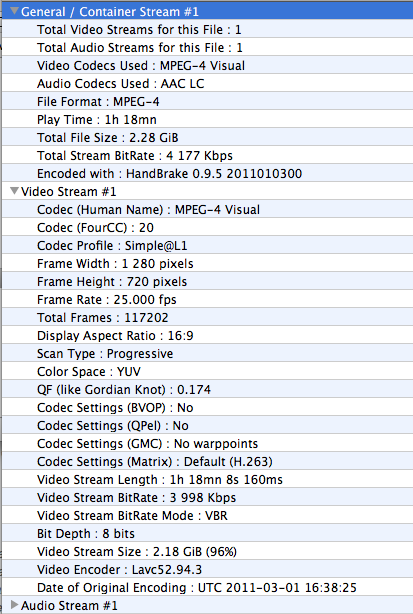

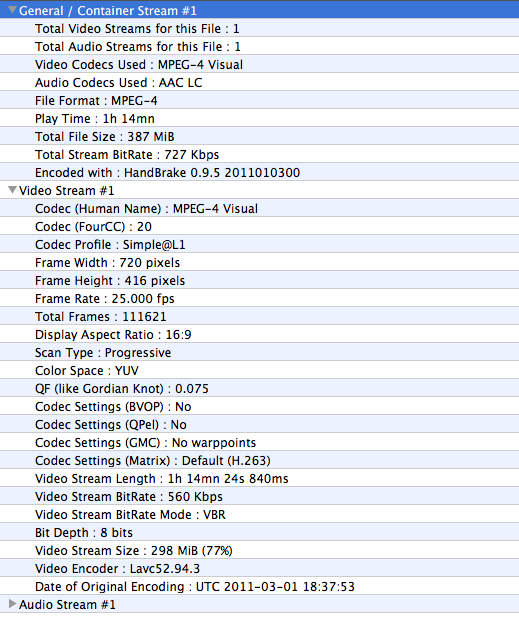

Thx - I've now used Media Info to extract video-compression-info. I've attached the info here; the first image is the one that works fine on PC, the second does not ... any ideas why??
The videos that work are SD (720x480 or close to that), the ones that won't work are HD (720p 1280x720). Commercial PC's are often not purchased with the graphics hardware necessary to run HD video, and that's probably the problem.
