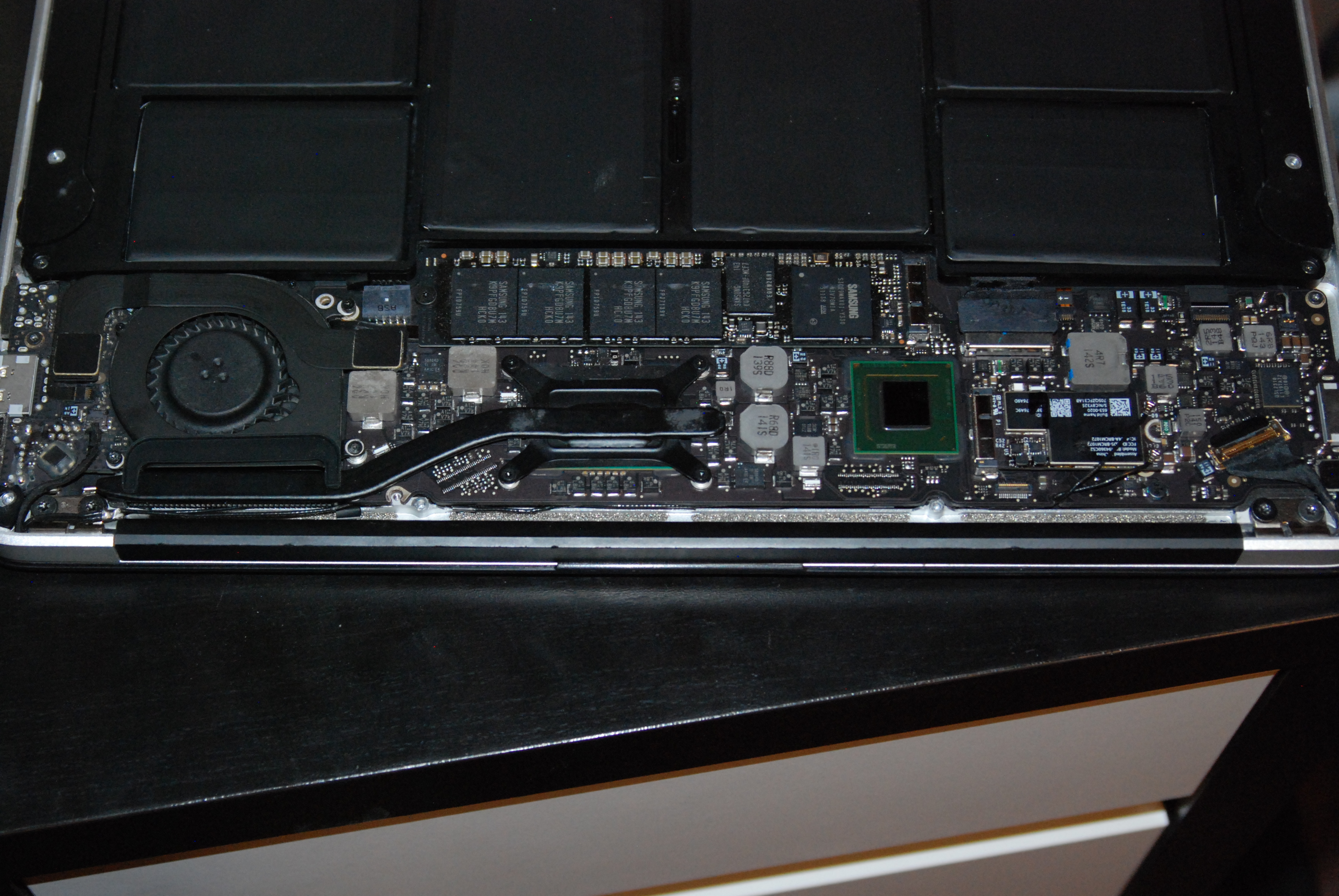

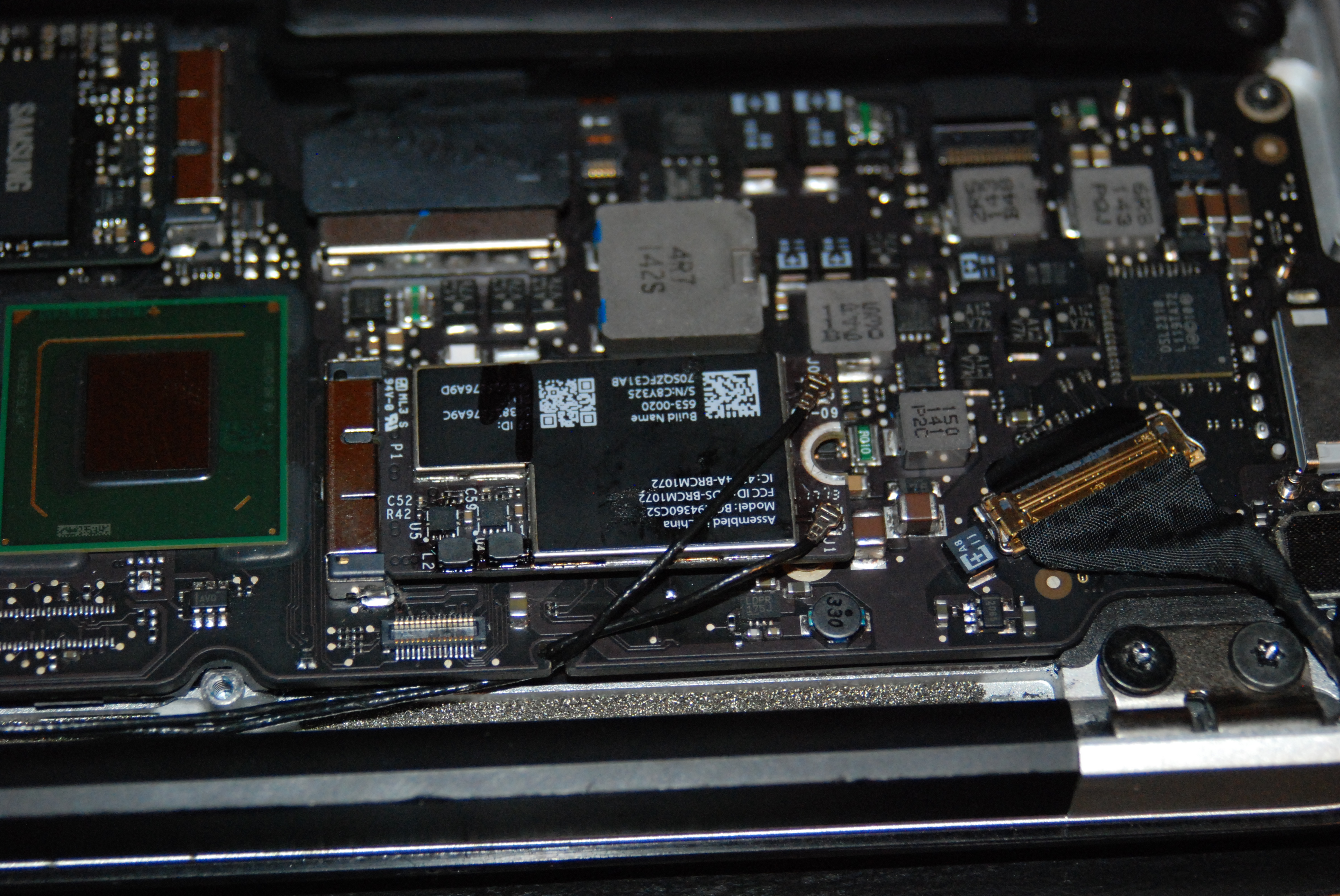

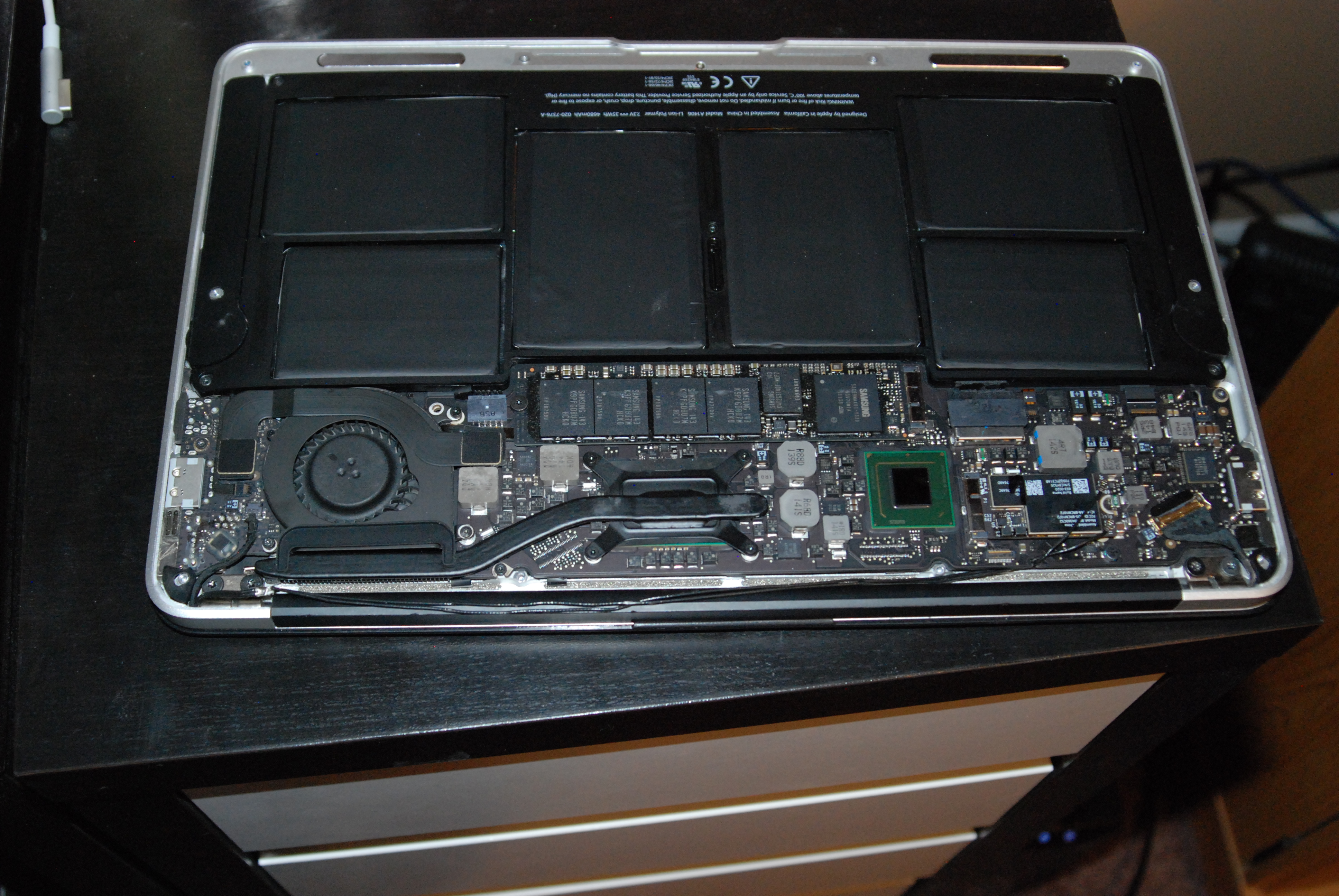

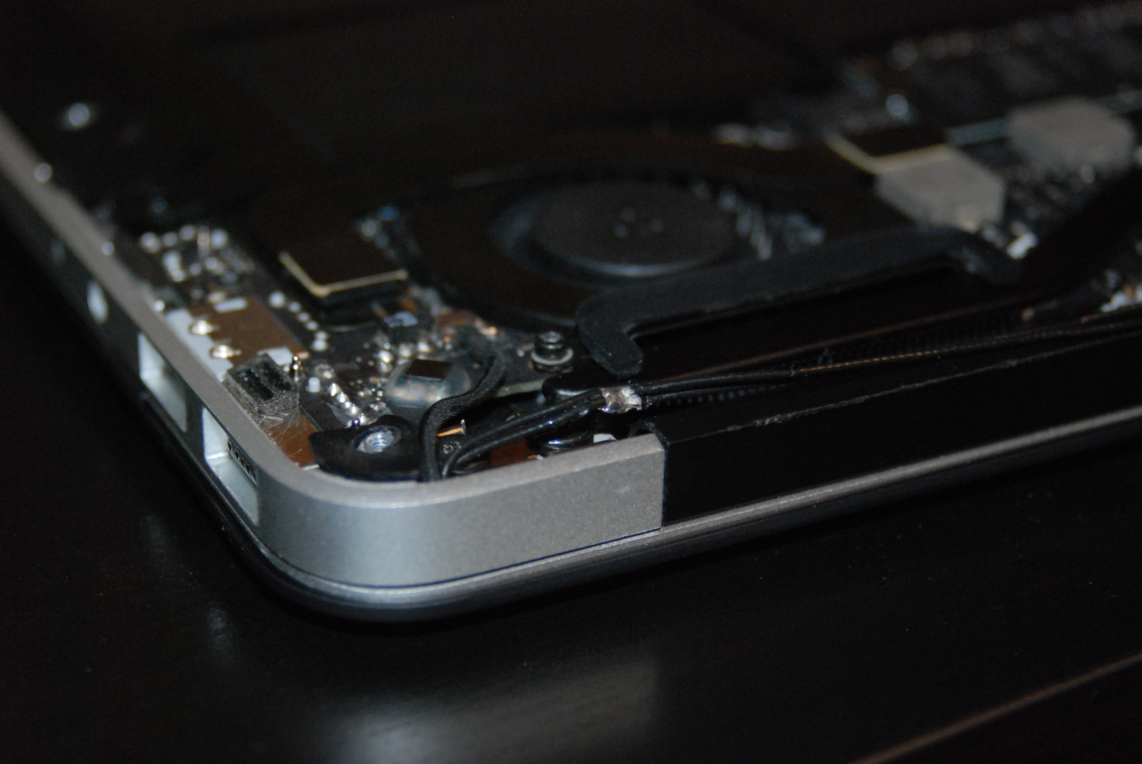

Here you are. The third picture shows a little piece you have to snap off the hinge piece, they solder the wires on so you have to clip it off but as you can see everything goes back perfectly.
the 4th picture shows how the new card is a little longer and the last picture is the wires rerouted so it looks just like normal again. I hope this helps people with the air. any questions feel free to ask.
