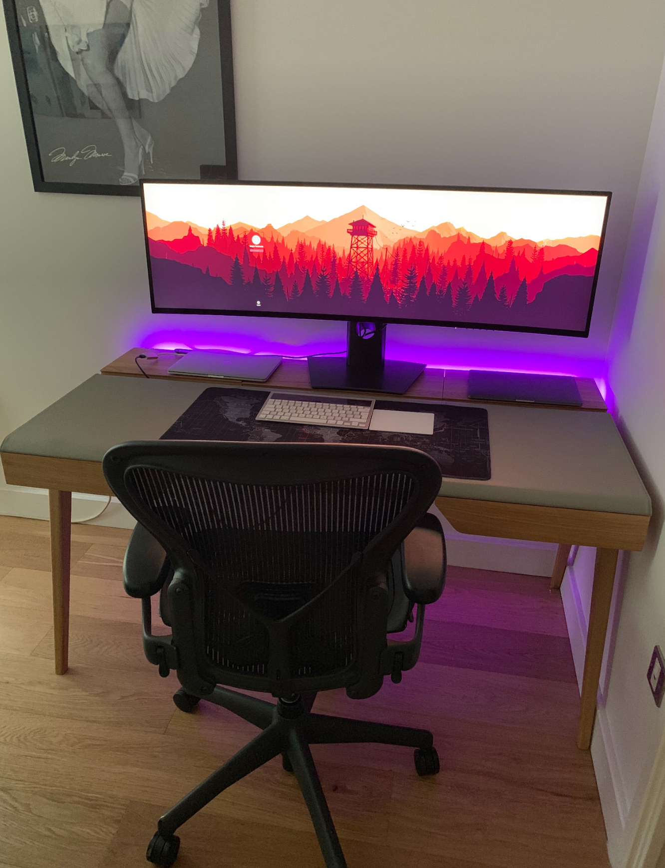

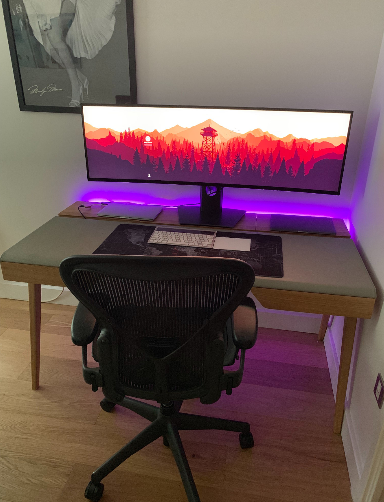

Finally got some good news here. I upgraded my MacBook Pro 13" (2019) to Big Sur 11.1 and as of right now the LG 49" display runs at full resolution 5120x1440 over USB-C without an eGPU. I heard there was a rumor that it might work so I gave it a try and it is working great and so much quieter.
The issue with 5K timings (any timing > 4096 pixels wide) for Intel graphics (before Ice Lake) was fixed for some Intel CPUs (Kaby Lake and Coffee Lake) with the first Big Sur betas back in July or whatever.
