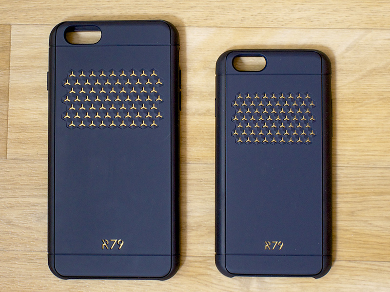

Earlier this month, we shared an iPhone case called the Reach79, which debuted at CES. The Reach79 case claimed to boost the signal strength and performance of the iPhone, improving battery life, reducing dropped calls, and improving download speeds, statements that were quite controversial in our forums.
Readers were understandably skeptical of the Reach79's promise that it could deliver up to 2x stronger signal strength, so MacRumors decided to go hands-on with the Reach79 case to see if we could prove the company's claims.
We've been extensively testing the Reach79 case on an iPhone 6 Plus for more than a week in various areas around the San Francisco Bay Area, but after several days of use, it remains difficult to conclusively say that the case improves signal in a meaningful way due to mixed test results. For a quick summary of what we found, scroll down to the "Bottom Line" section, or read on for our full results.
Our Testing
We used the Reach79 case on an iPhone 6 Plus connected to the AT&T network on multiple days, at multiple times, and in multiple locations, both indoor and outdoor. The phone was put into Field Test mode so that signal strength could be viewed as a raw decibel number rather than as dots or "bars," in order to better determine if and when the case was improving signal. All testing was done in the hand or up against the head, which is how the case is designed to work.
We also tested with the Ookla Mobile Speed Test app to see if the case improved data speeds, but we were told that this is not a particularly reliable testing method due to the many factors that can affect data transfer.
If there's one word that sums up our testing, it's inconsistent. At times, when the Reach79 case was placed on the iPhone, signal definitely improved as evidenced by the raw numbers and speed tests, but just as often, putting the case on did nothing to improve signal, or even seemed to degrade it somewhat.

Parasitic antenna elements (as on a yagi or beam antenna) don't boost signal overall, they just aim more RF power or sensitivity in certain directions (and thus less in other directions!). So whether there is any benefit depends on exactly how you position or aim the case, where the cell tower is located, and how the RF waves are bouncing around in your exact locale, which can be nearly random. Thus the random results.
So the bottom line is, the case might improve the signal, but only very slightly or it not at all.
What is more measurable are the price and overall protection the case offers. The case is clearly overpriced and while it does seem to offer at least solid drop protection, it looks rather bulky and all those holes are just asking for dust and other particles to squeeze in between the phone and the case, eventually scratching the phone's surface.
