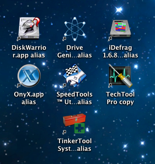

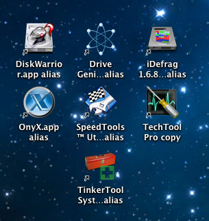

Hi,
I have this utility (and more), but most of them are commercial (the good ones) and cost AS MUCH OR MORE than a new hard drive:
I still think you may be better off with a new hard disk, but I suggest you erase and install snow leopard, and then just restore the documents and folders that you need from time machine backup. I would reinstall all your apps from disk.
