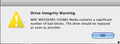

This may be a stupid question, but can I do it in Parallels. I am not sure if I can get my hands on a desktop PC with a SATA port. or would using my enclosure with a PC be just as good. I attached a picture of my error and as far a software are you talking about using something like Data Lifeguard Diagnostic (http://www.wdc.com/en/products/products.aspx?id=120)

Almost certainly your enclosure is too dumb to report issues.
It's irrelevant though. That is not a trustworthy drive and it must be replaced.
