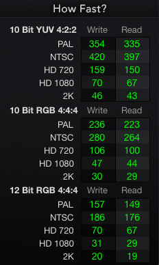

I'm currently getting the best times I've ever seen from a consumer grade drive in the Seagate Barracuda 3TB 3-platter models (ST3000DM001). When two are in a RAID0 array they compete with fast SSD units... Only with enough space to actually be useful... 😉
2-Drive RAID0
One should be about half this.
2-Drive RAID0
Nice. The new single TB platters get 200+ read/ write for probably 400+ in 2 disk RAID0 stripe. So those are my fastest ever seen. But they are Seagate so they'll probably blow up on you.
