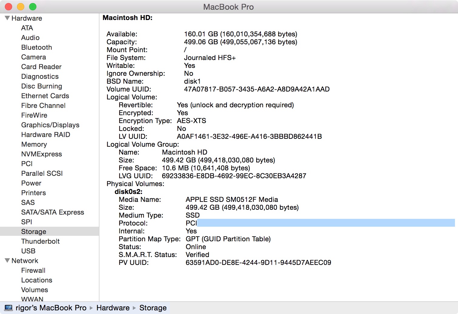

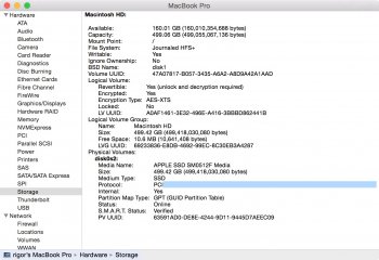

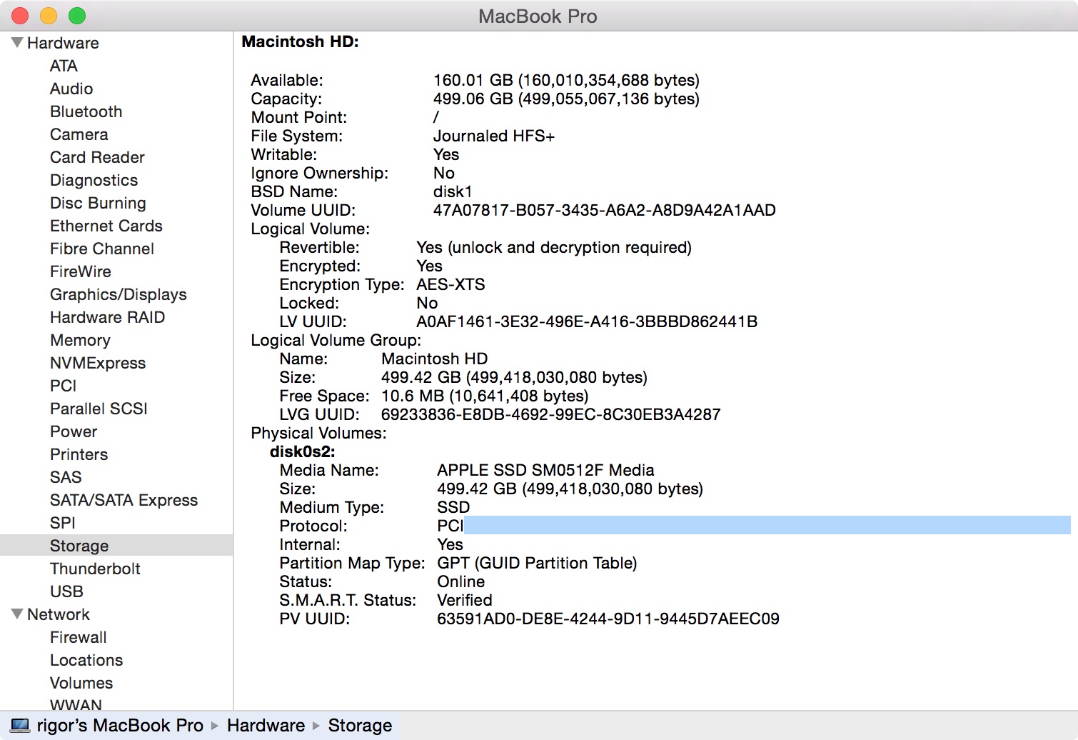

if you feel that there is a sector failing, the means your hard disk HAS FAILED AND IT NEEDS TO BE REPLACED PERIOD.
the quickest way to find out the smart status of your drive is system report, if it says anything but "verified" throw it away. disk utility used to show s.m.a.r.t. status but apple removed it
AHT, Apple Hardware Test does not read hard disk status. it only checks to make sure its been installed.
the best way to check for bad sectors is to do a complete wipe of the disk. 1 wipe is good enough, but the more the merrier., complete wipe of course does not apply to SSD
smart status is NOT AVAILABLE on any USB DRIVE , if you want to check that, you need to take the enclosure apart and connect it internally
"sector failing"
every single hard disk ever made comes from the factory to you with bad sectors. these sectors are marked out by the factory. if the hard disk finds a bad sector over its operational life , it automatically relocates your data to a bank of spare sectors and never informs the operating system.. once it has run out of spares and the OPERATING SYSTEM finds out, it means YOUR DRIVE IS SHOT
once a hard disk has tripped its s.m.a.r.t. sensor no software utility can help you. don't spend any more money. just buy a new hard disk or see if your hard disk has any warranty coverage from apple, applecare or the hard disk manufacturer ( like if was purchased in a retail box )
if anyone tells you differently, like you just need a low level format utility, RUN AWAY. there is no such thing as a LOW LEVEL FORMAT that was something that we did with MFM and RLL hard drives that used the ST506 interface, and ever since we used IDE in 1990 that ability was removed.
