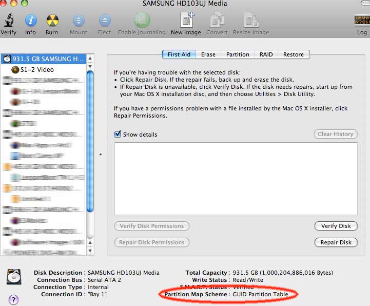

one thing I failed to consider is that this used drive is formated far an intel based iMac, and this is the reason it is not mounting, is there any way to find this out in target disc mode?
Yeah PowerPC Macs can't read Intel partitioned boot drives.
Yes, you can check it using Disk Utility on the running Mac- click the drive in the left column of DU (not the partition- the drive as illustrated below) and look at the info at the bottom of the page where indicated.
If it reads GUID as the example does, it can be used for a data drive but will not be bootable on your PowerPC based iMac. In order for a drive to be bootable on yours it needs to read "Apple Partiton Map" instead (which is set up during the initial partitioning and erasing of the drive via the "Options" button in the Partition pane of DU).
