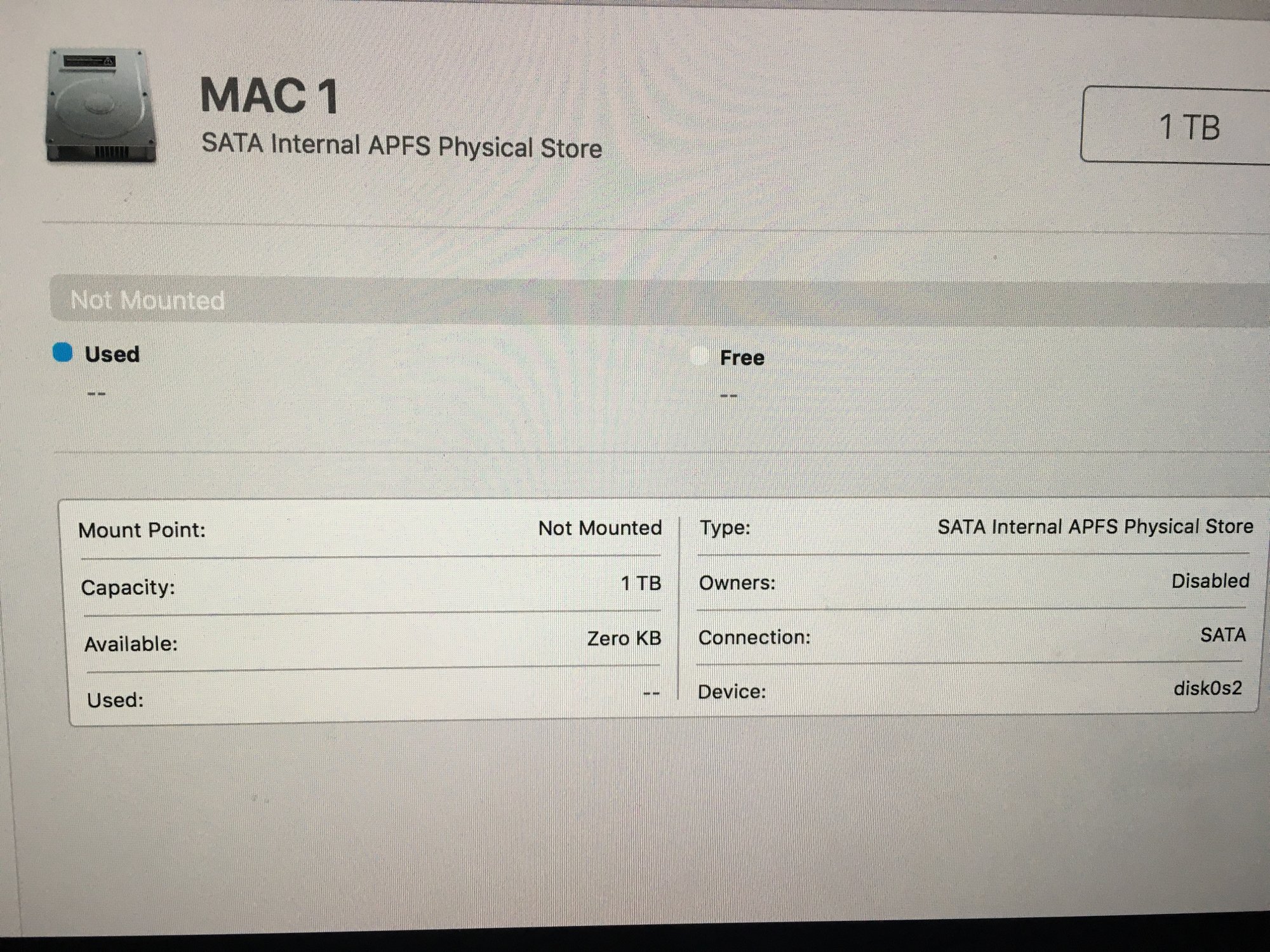

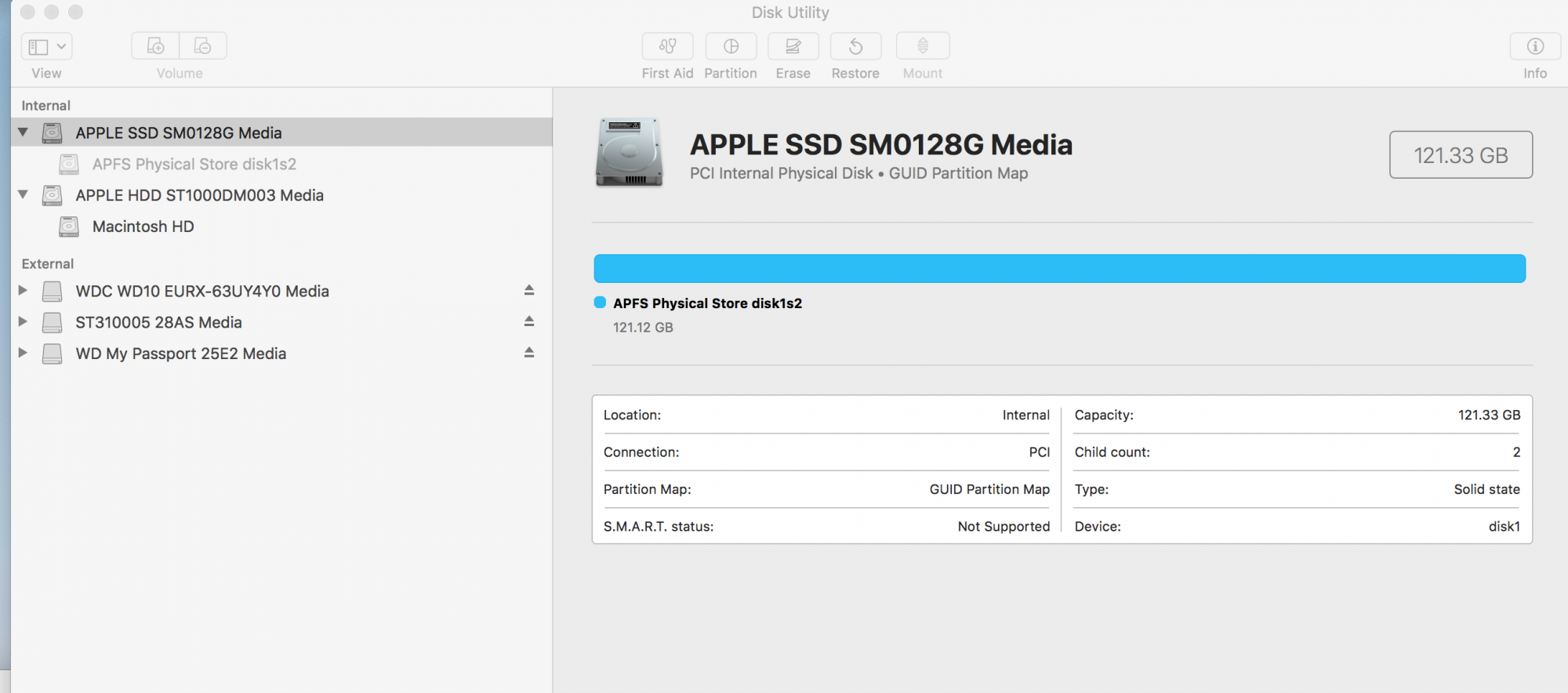

OK Thanks - this was a 1TB drive
I have attached a screenshot of drive ...
I have erased it a few times and tried to load various OS onto it ...
The price is £100 for drive £80 for install
What I am concerned about is that I can run High Sierra on the current internal drive - but no higher
I can also run these on 3 different external drives I have (not USB3 though) - and no higher (not Mojave or Catalina)
Are you suggesting I can just buy an external SSD drive - 1tb or 2tb and use that as my main drive ? Do you think I will be able to load Catalina onto that if I can't load it onto the current external drives I have ... ?
is that 85% speed of a new SSD internal or 85% speed of the older HHD drive
Thanks for your help

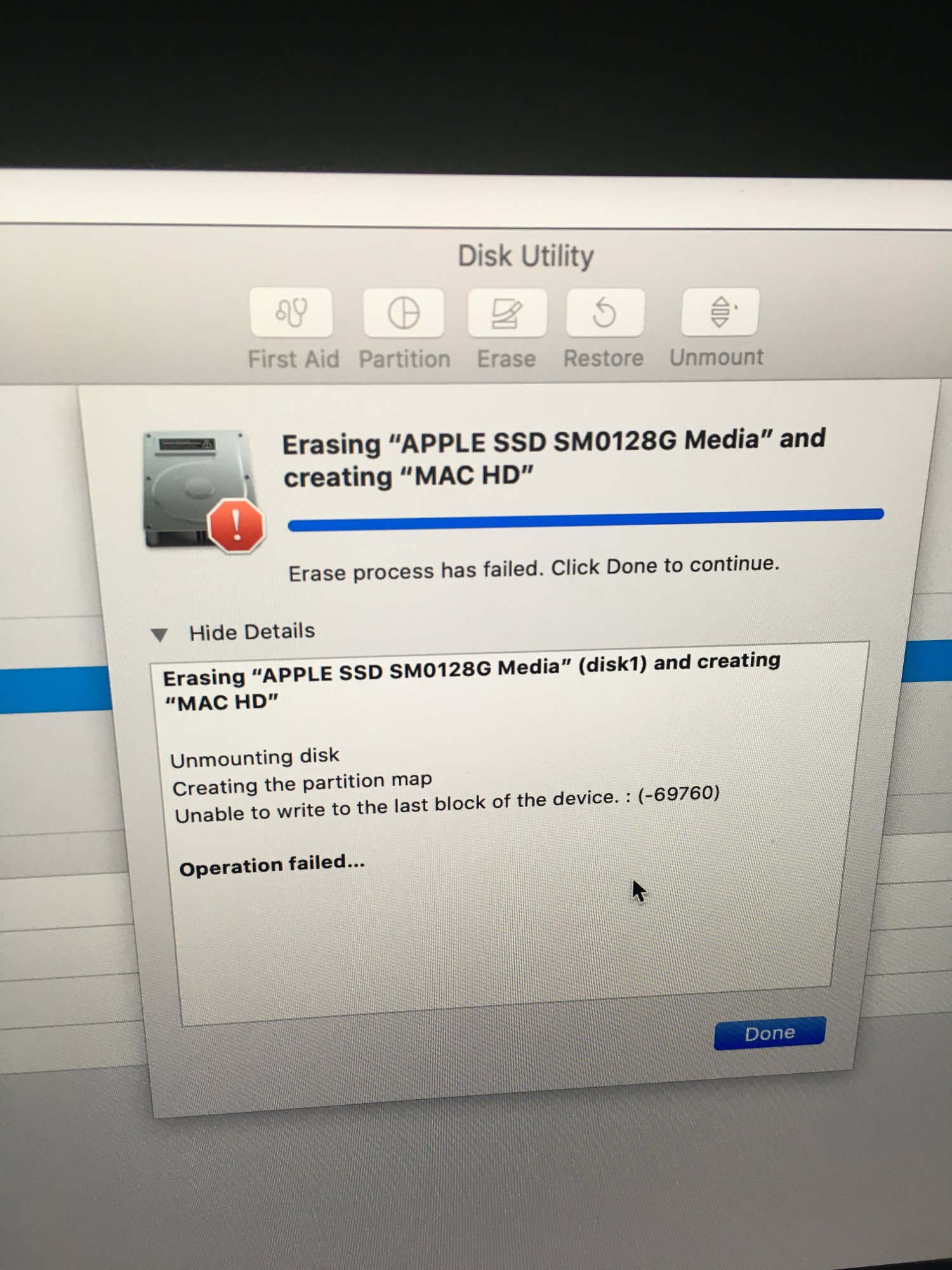

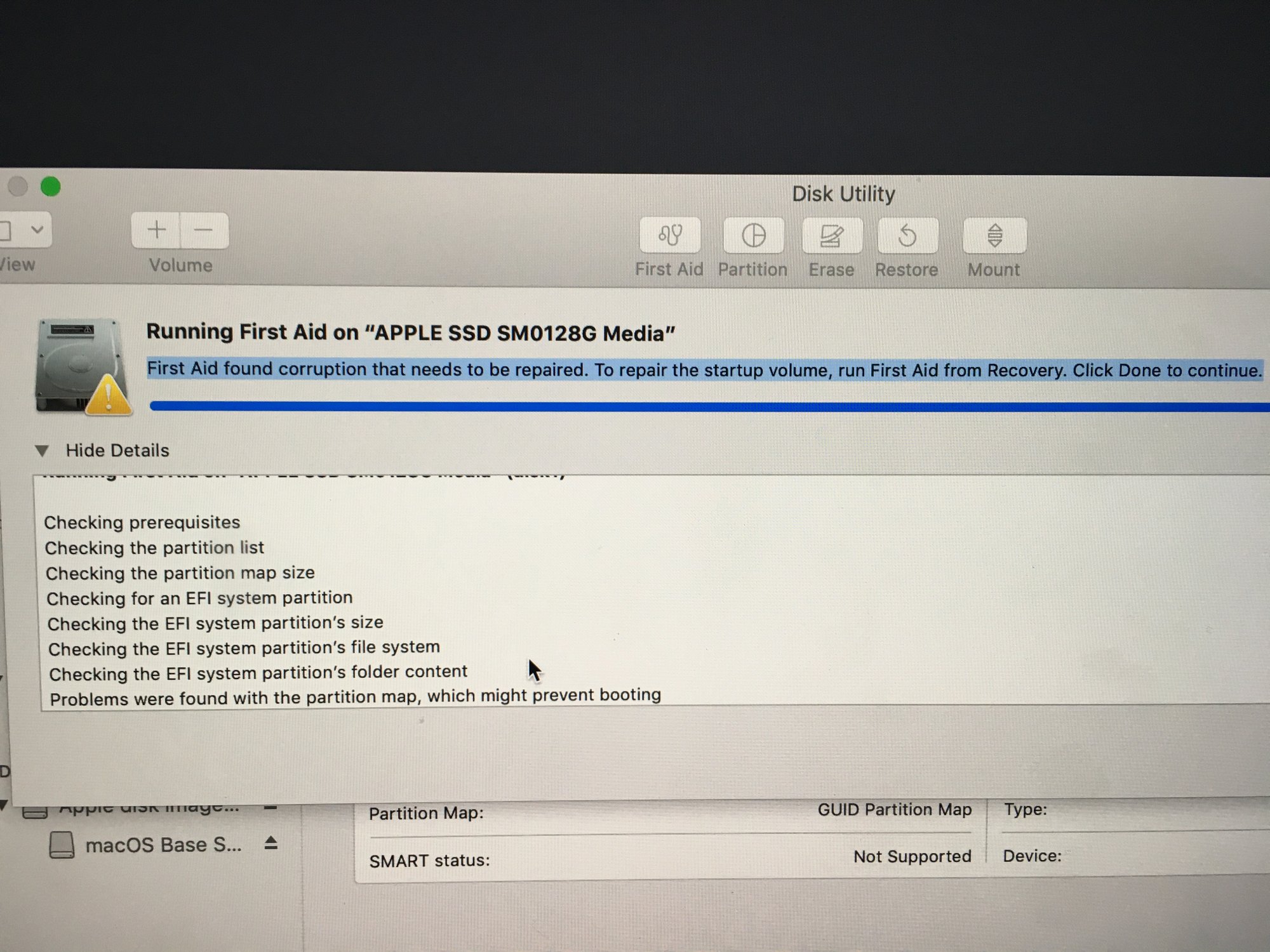

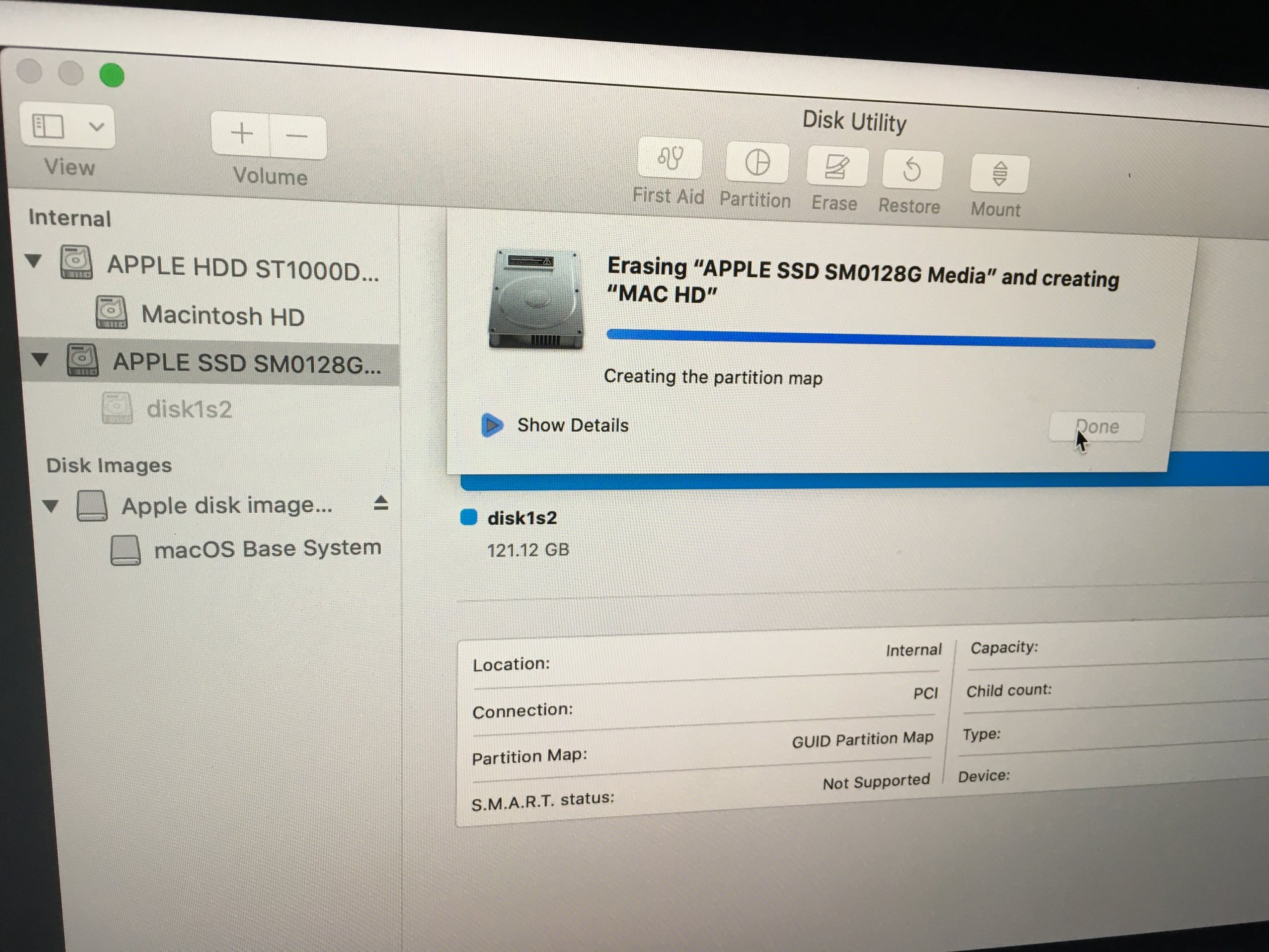

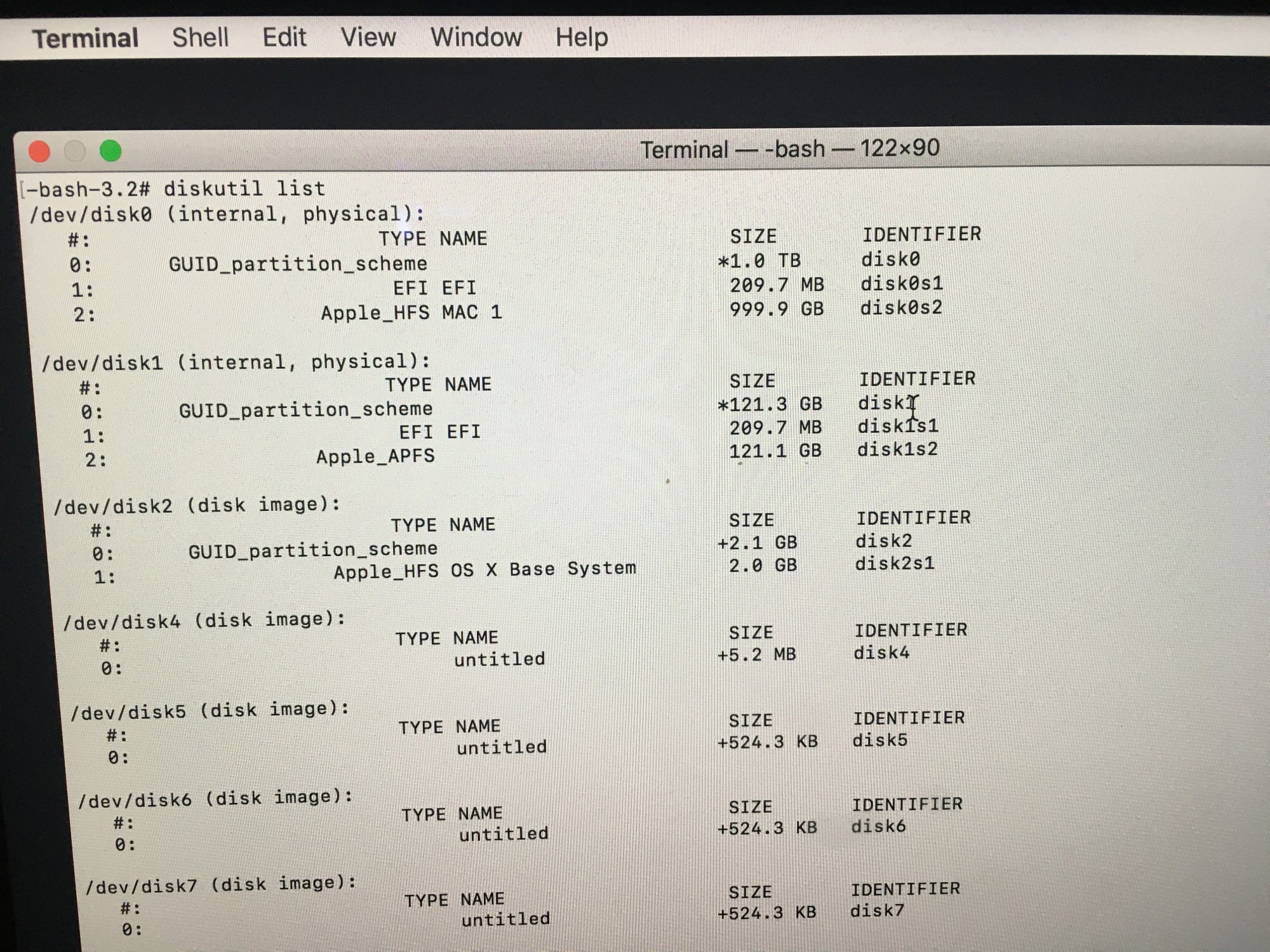

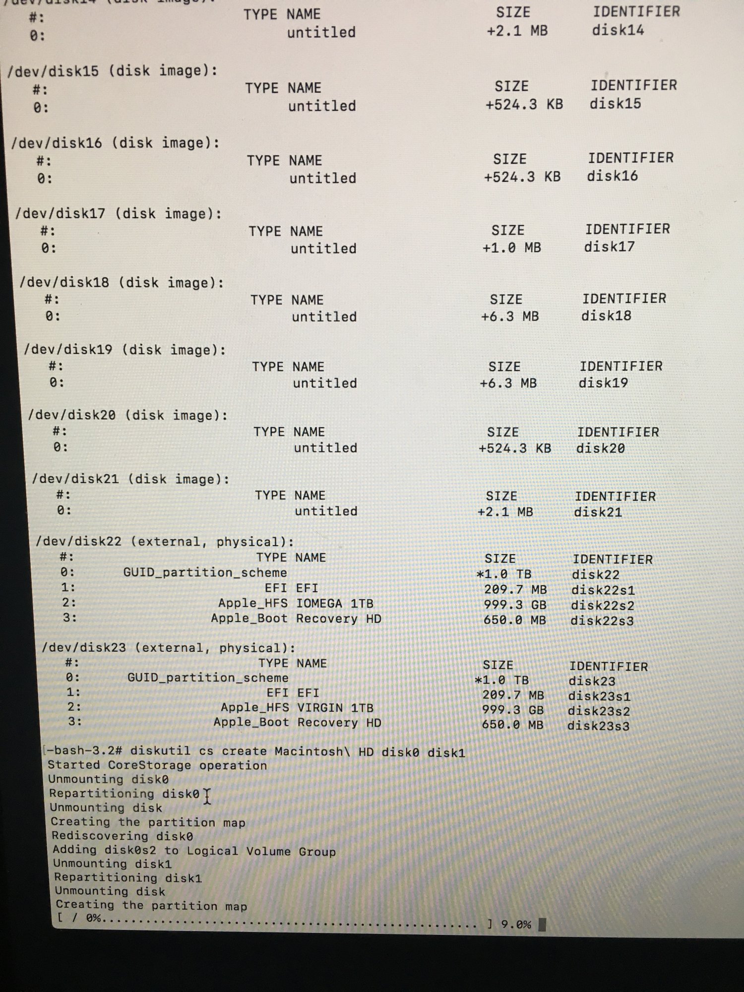

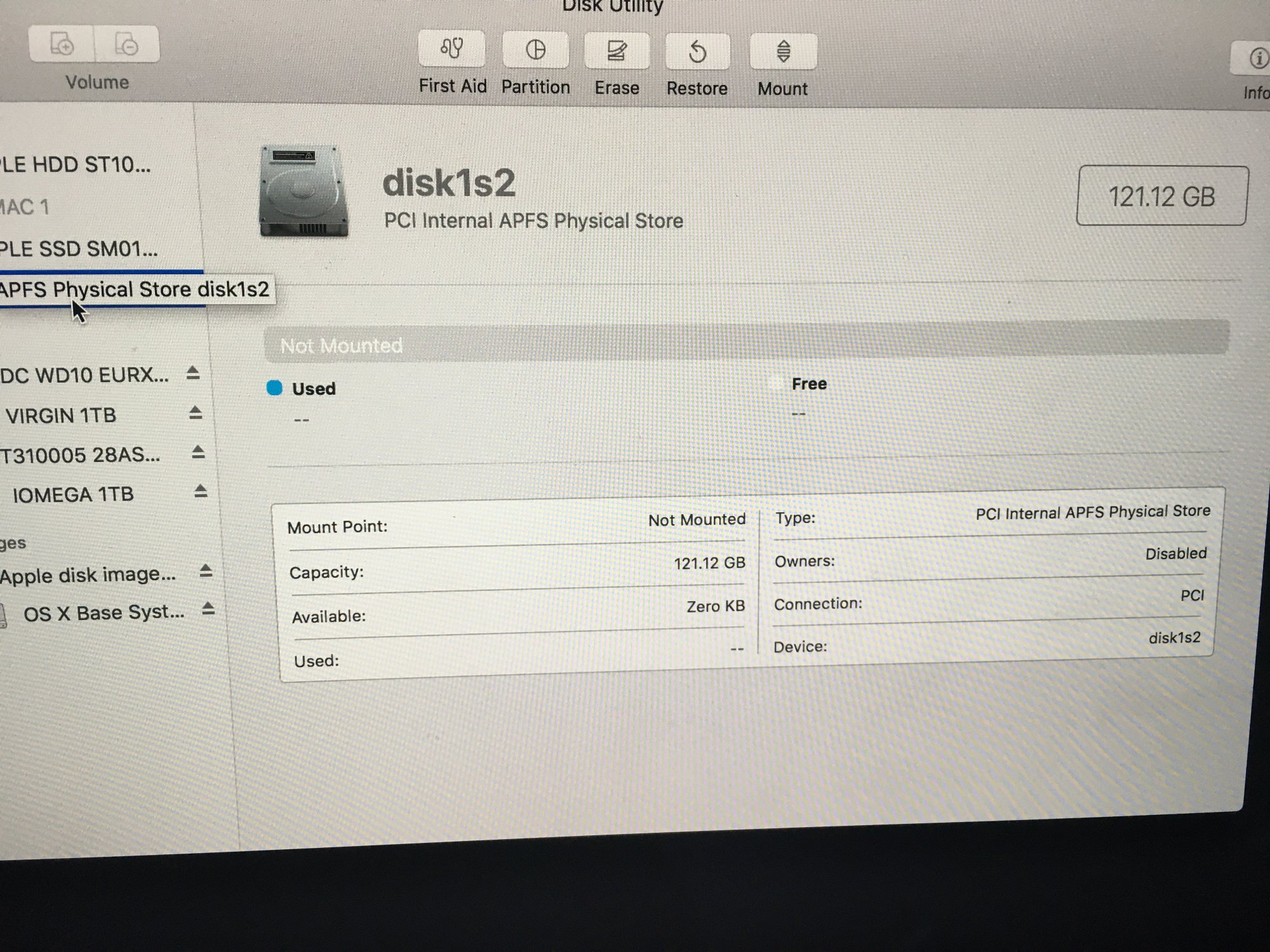

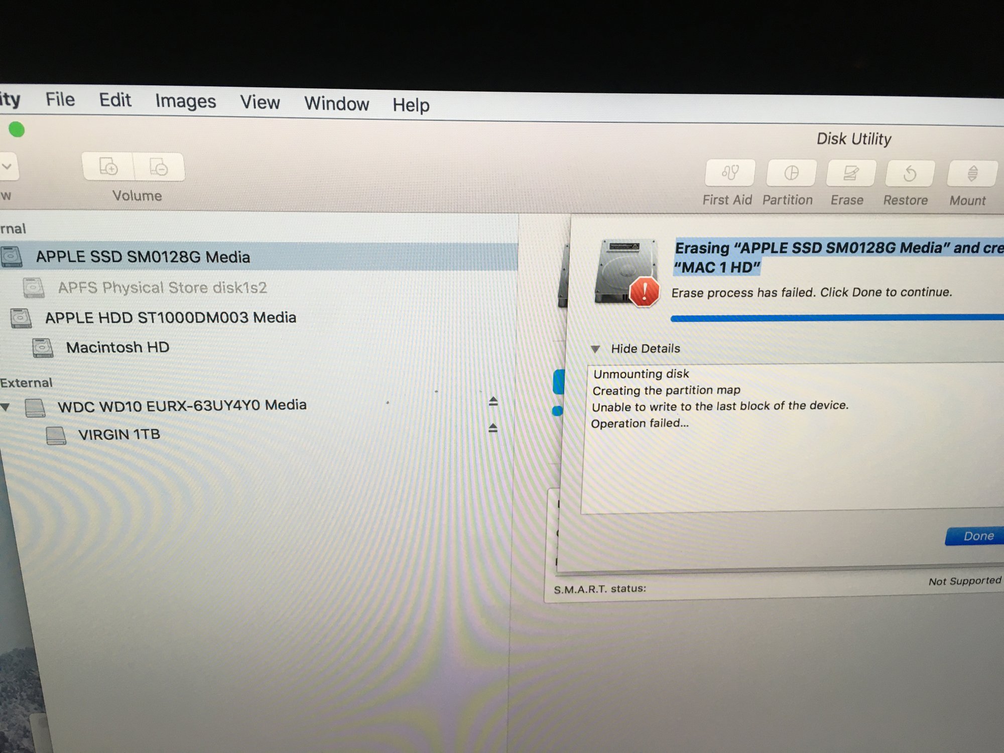

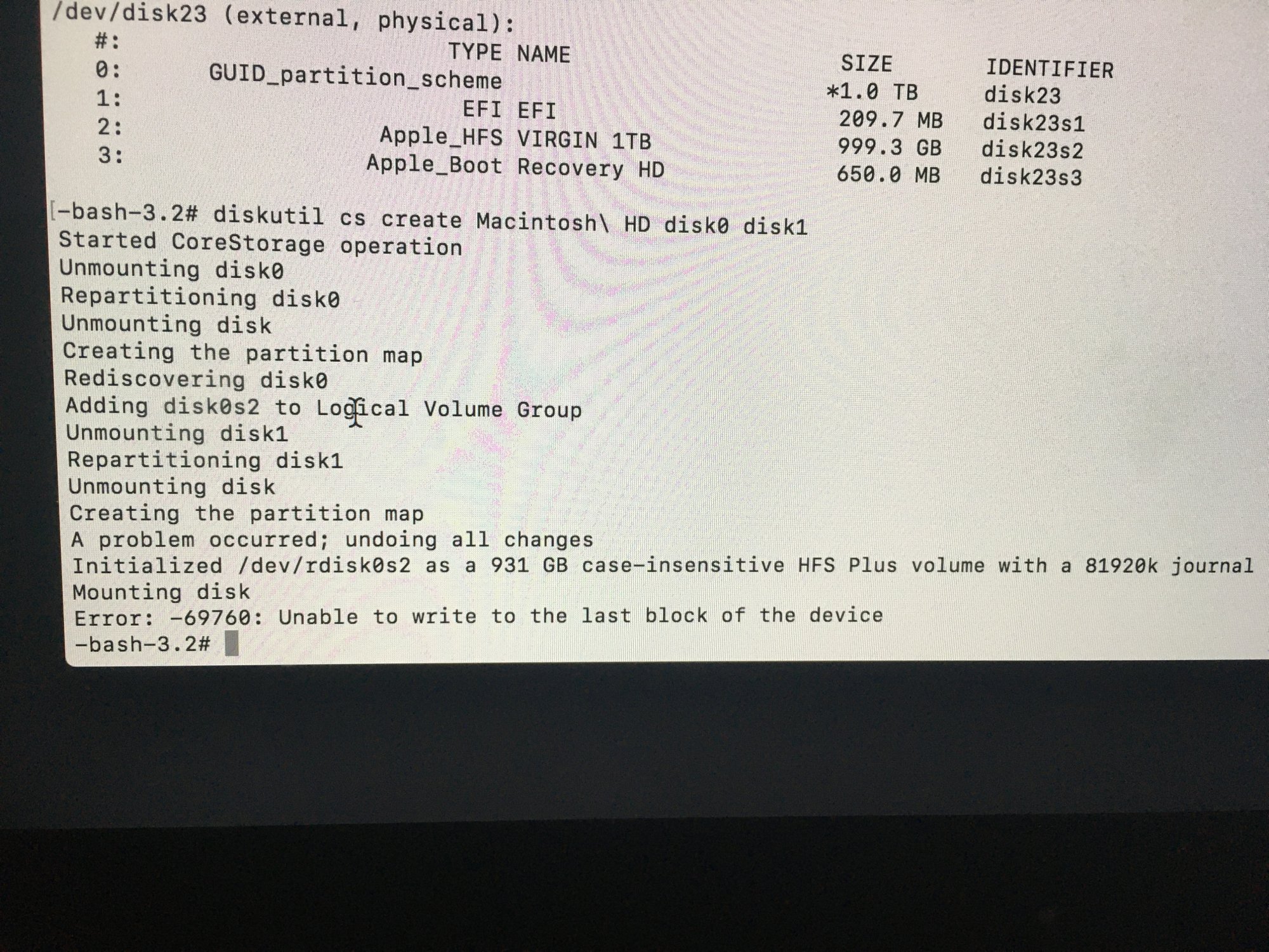

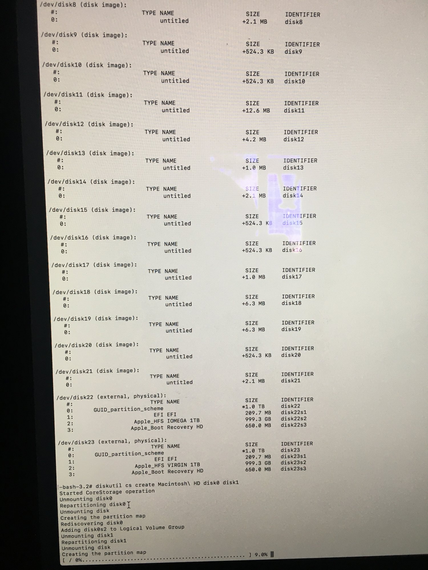

First aid suggested I repair from recovery ... but on Mac I can’t get into recovery ... command r just starts internet recovery
Having tried many times the hdd drive in the fusion seems to work and erase / load fine... but the ssd part of drive seems faulty
any thoughts ?

From the image you posted in reply 9 above, you have the [former] fusion drive "split apart" into it's two components:
- SSD, 128gb
- HDD, can't tell what the size is.
Do these drives currently "show up" on the desktop?
Or, do they remain invisible to the finder?
Or, does only ONE of them show up?
(it looks like the HDD portion named "Macintosh HD" might be mountable)
WHY I'm asking:
If they "show up", then it sounds like you're re-initialized them (erased them) to be "standalone" drives. Be aware that doing this will DESTROY any data that formerly existed on them when they were "fused together".
If they have never shown up since they got "de fused", then the data that was on them might still "be there", but I'm not optimistic about that. The only way to "get at" that data would be to "RE-fuse" them, and I'm wondering if doing so (using the terminal or perhaps disk utility?) would in itself wipe out any previous data.

Have you tried erasing the internal SSD?
If not, I'd suggest you try it.
Click on the "top line" in disk utility to select the drive, then click erase.
Choose "Mac OS extended with journaling enabled, GUID partition format".
Does it erase and mount?
Thanks, yes tried that - pretty sure it’s the ssd part that is broken.
is there a way of just forgetting the ssd part and using the hdd part to run Mac
if not external ssd may be the route. What is best - a purpose built ssd external or buy and use internal ssd - presume some wires or conversion kit are needed?
