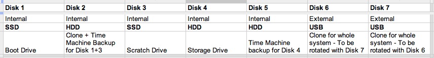

Ok...so I think this is my final setup. I feel like maybe there is too much redundancy (like, can't I get rid of Disk 2 all together since Disk 6 and 7 already are clones?). But maybe there is no such thing as too much? These drives have the last 5+ years of work on them...if the disks went bad, or were stolen/fire/etc...we would be royally screwed.
Disk 6 and Disk 7 would be rotated off-site.

You could consider something like this:
  • Disk 1: SSD Boot disk
  • Disk 2: SSD Scratch disk (40GB model from OWC can be had for $100USD; here).
  • Disk 3: 2 - 3TB mechanical disk for primary data
  • Disk 4: Clone of OS (use the 320GB)
  • Empty ODD bay: 2- 3TB mechanical HDD (Time Machine or other backup software controlled)
This will help, but the primary storage pool is still a single disk. To get this faster as well as redundant, you'd need to run a RAID 10 (what OS X can do without the need of a RAID card), or get a proper hardware RAID card and run a parity level, such as RAID 5. Either way, it means more money (RAID 10 would require a minimum of 4x disks + external externals for at least your backups/clones, and a RAID card + enterprise disks + external enclosures for the backup/clones will be even more $ than that). Exact cost would require specifics...
But you've still not indicated budget, capacity, growth, or throughput needs, so all of this is just general ideas ATM. Meaning, it may not really be the best fit for your needs. This is where the specifics come in (again 🙄). 😛
BTW, you do not need to backup the scratch disk, as it's temporary data.

Thank you for cleaning that up. It's what I suspected, but wasn't sure. Either way, I'll have the space on Disk 2 since I'll be using a spare 1TB HDD that I already have.

You should be able to manage this then if you don't go crazy on the SSD used for the boot disk (say 80GB max, and I suspect the OWC 60GB would be of sufficient capacity as a boot disk, which is ~$139USD). Neither this or the 40GB versions are 6.0Gb/s, but they're fast, and quite good for random access. And more importantly, would allow you to stay within your actual budget. 😉
