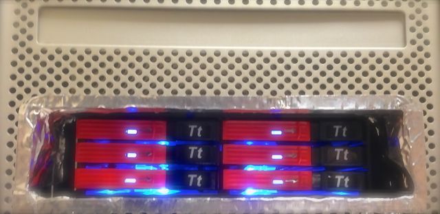

I've installed 4HDD & 6SSD into my mac pro(E2009).
Areca 1880i:
Samsung 840Pro x 4 360G RAID5 - OSX System/Application/Users
Hitach HDD x 4 6T RAID5
3T - Media/Library
1.5T - Windows Users/Program files
1.5T - Time machine for OSX System/Applications/Users
Secondary Optical bay standard SATA2:
Apple 120G SATA2 SSD
40G - Rescue OSX System
80G - Bootcamp Windows 8 System
Bay1 standard SATA2, routing from Maxupgrade mounter:
Intel 80G SATA2 SSD - Scratch/Temporary
My policy for high-availabilirty is simple, "always have at least one spare HDD".
