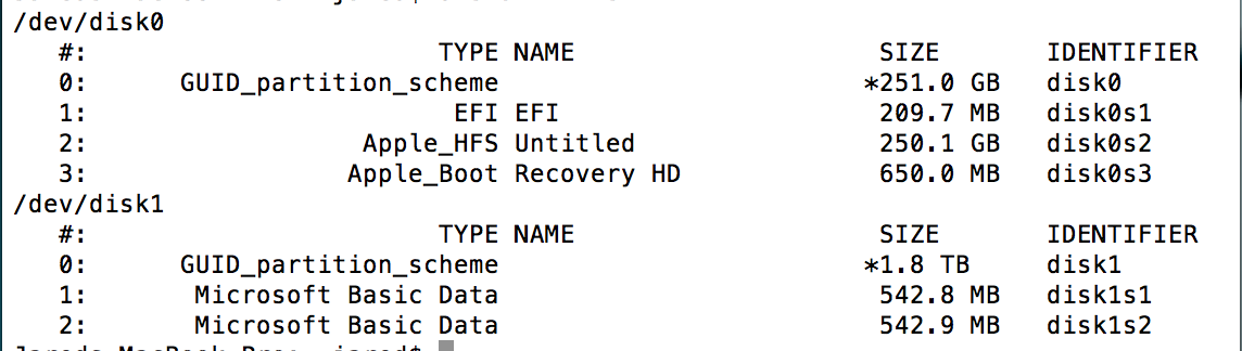

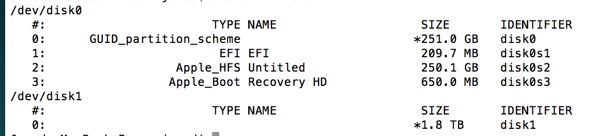

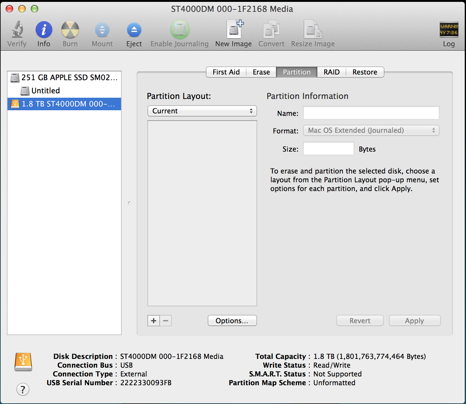

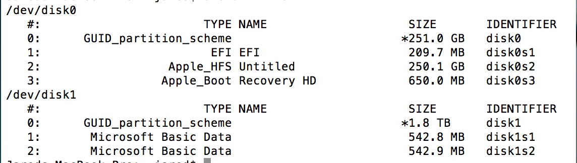

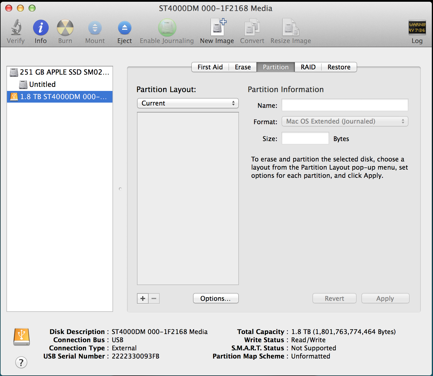

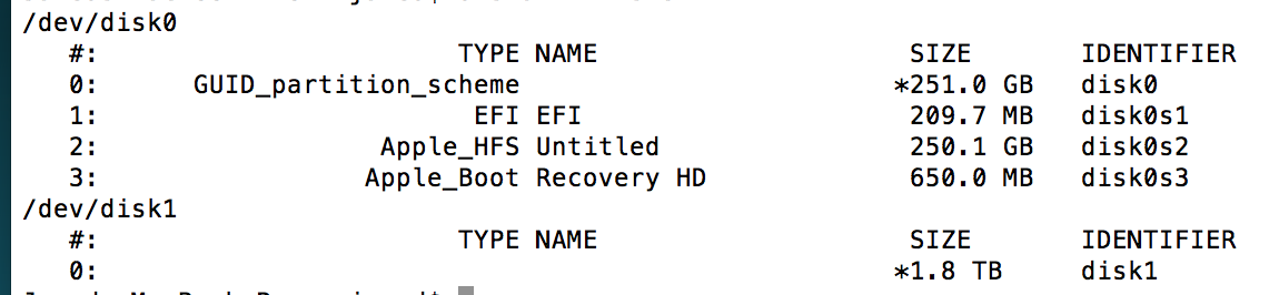

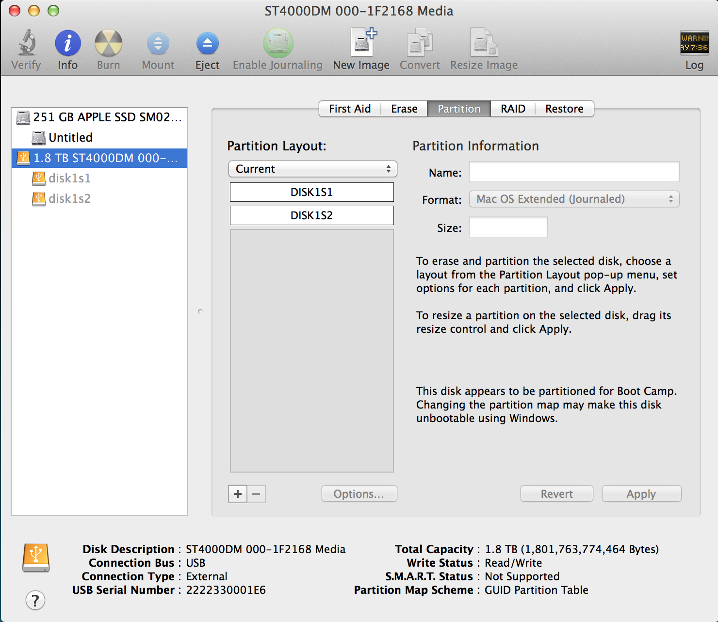

Below i took sreenshots.... First ones are taken from completely blank hard drive, (after zerodisk the 4TB out from a PC), and the 2nd set of screenshots are "before* wiping out anything. (from the 2nd 4TB hard drive from NAS directly)

This is definitely the usb enclosure that does not support 4TB drives.
But OP seems to be saying he is using the same enclosure on the PC.
