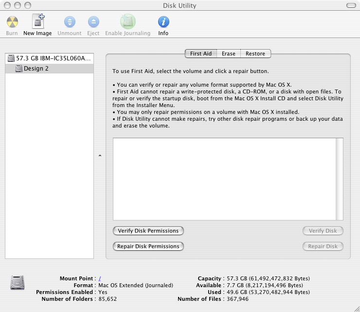

How about some screenshots to help us interpret what you're seeing?

But if that doesn't work, can you give us a screen shot of Disk Utility with your hard drive selected, or at least tell us what it says. Maybe something is getting mounted wrong. (Note: I doubt this is the problem, but we are running out of ideas. It's time to start check everything no matter how unlikely).

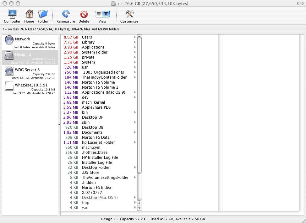

I have attached screen shots of both the omnidisksweeper and my disk utility...

ODS is not giving you the correct info.. are you an admin on the box? Please post the results of (from Terminal.app):
du -h -d1 /
(it will take a while)
Oh.. and for the record, you seem to be using a Norton product. Is it Norton AV or something else?
It might be a good idea to pipe the results of "du -h -d1 /" to a file, like I suggested before - you are going to get a very long list.
And please, try WhatSize. It's pretty much the same as OmniDiskSweeper but may give different results.

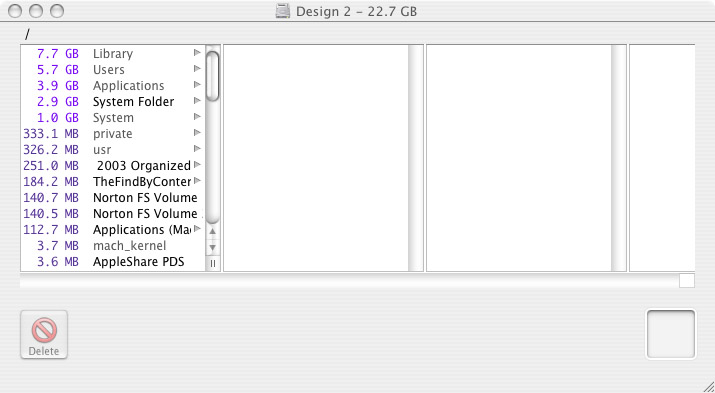

ok.... I hope I'm doing this right. Here is a screen shot of "what size" and below is the information I got from "terminal"

why is it that in "what size" on the top portion it says 26.6 GB but on the bottom I'm using 49.7GB? I know it wouldn't be the exact same number but shouldn't it be close?
Off hand I'd say that it's registering what can be see in the Finder. You'd have to look at the whatsize documentation for what that means.
When I add up all the items in "What size" it still only adds up to 26.6GB...
Where is my other 23GB?

I went into the admin account and did the "terminal" and the "ODS" Please see attached.
When I was in the admin account the hard drive had the same information regarding how much space I had available.
