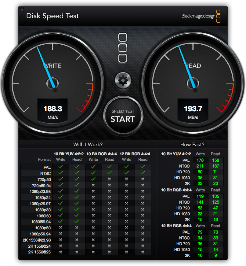

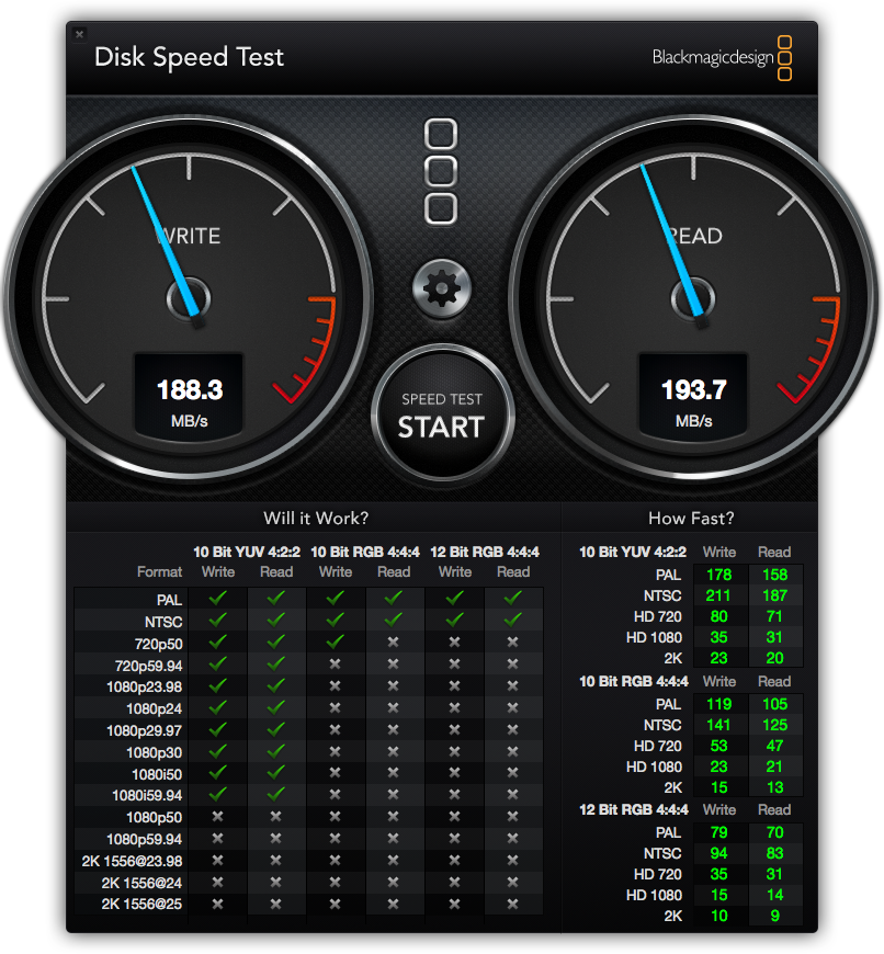

Just for comparisons sake...
I have 2x 3TB WD USB3 drives attached to my 2012 Mini in a RAID0.

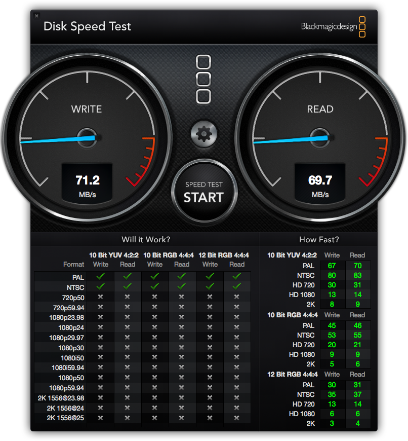

Ok newbie to Thunderbolt
Hey guys,
I've got a pretty quick setup here in my office:
iMac 3.4Ghz Intel i7
16Gb 1333 DDR3
SSD 256Gb HDD 1Tb

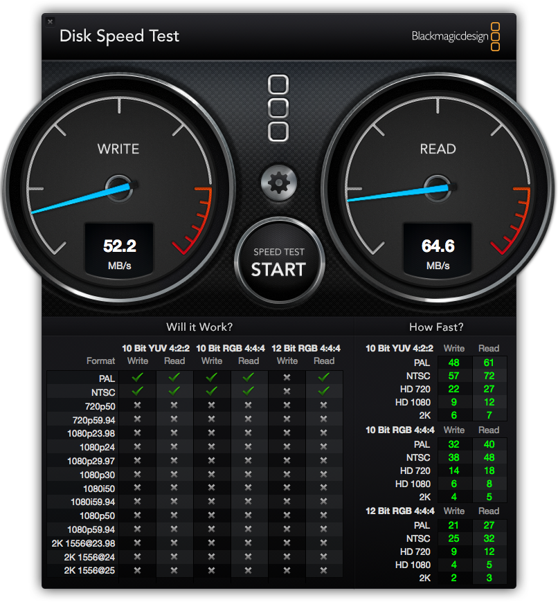

connected to a few USB 2 drives for backup/storage, I use FW800 Lacie Ruggeds for storing RAW camera files (I do lots of video editing using FCPX) and have just added a WD Thunderbolt Drive 4Gb set to RAID1.
Thought I'd do a Blackmagic Speed Test and was horrified by the results to be honest:
TB - 70Mbs
FW - 55ish Mbs
So what on earth have I got wrong with my setup that's making things operate so damn slowly. Surely I should be looking at figures of at least twice that?
Any help with my problem would be gratefully received,
Thank you!
Ben

Internet says the Duo 4G uses caviar green drives, which are 5400rpm. And you're using RAID-1 (redundancy) instead of RAID-0 (performance). I'm not sure I'm looking at the right thing, though, because it didn't have fire-wire ports.
As stated, TB won't magically improve drive speeds, it just offers much more bandwidth for data to transfer over.
Thanks for the reply Pakaku,
You we're in deed looking at the right thing, I was referring to the Lacie drives when I was talking about the fire-wire ports.
So the TB is for the WD Duo 4G, and the FW for the Lacie Rugged.
The reason I've set them up as RAID1 I suppose is paranoia. I run a small video production company and want to ensure that I don't loose any of the footage I've previously stored, hence why I've duplicated my storage...just in case.
Do I really need to be as worried that something is going to go wrong with the drive and I'll loose my data? Or is there a better way to insure myself against the issue?
In order to get the faster transfer speeds, assuming I use the standard Green Drives that the WD comes with, I really need to change over to RAID0 but if I do this now they are already setup, will this simply loose what I have stored on the drive - sorry a little confused?
