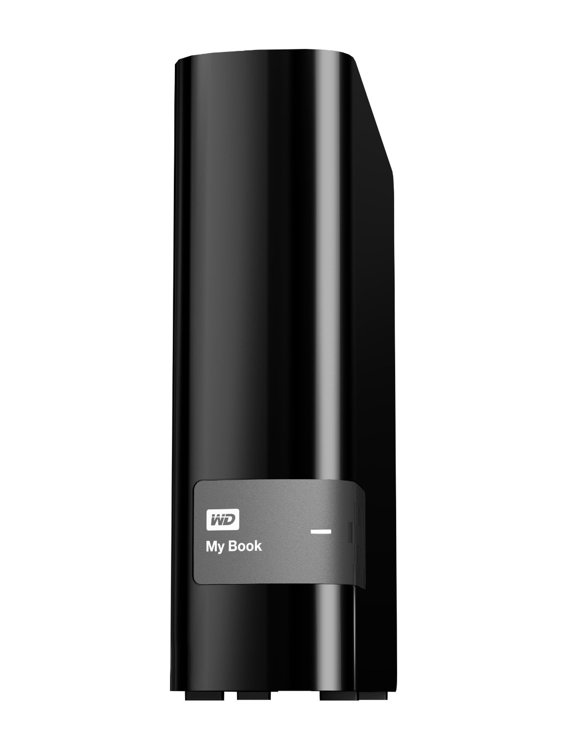

Those $439 buy you 3x 4TB WD MyBook, which gives you 12TB instead of 1TB. And if you RAID0 them, it'll be as fast as the SSD, too.
