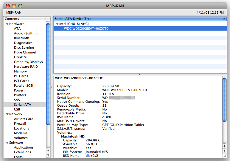

Good to know it went smoothly; however if you don't mind, can you go here and put your drive S/N number in? I just want to know if WD will know if the drive was a Passport drive or not.
http://websupport.wdc.com/warranty/...270&custtype=end&requesttype=warranty&lang=en
If you don't know to check your S/N, here is where in System Profiler:
The S/N part is the after the WD-______

I did what you want me to do, the website doesn't show anything about the drives being inside the passport or taken out. All it says is that I have Limited Warranty that expires in 2011 and I have 1 free replacement if anything goes wrong. Hope this helps. Thanks
Does the serial number listed on system profiler match the serial number on the enclosure? If not, I bet WD won't know that the drive was once inside an enclosure, so you should still be able to make a warranty claim on the bare drive.
The drive inside these enclosures is no different from a regular notebook hard drive, the enclosure and the drive have different serial numbers anyways.
