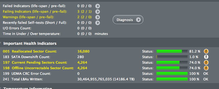

I've got an internal Seagate 3TB drive I've been using with my MBP, with an external enclosure and dock. It's been flaky: it often "ejects" on its own, especially when I'm transferring files.
I've run Diskwarrior on it--no problems shown. I've tried USB and FW docks and enclosures (3 different ones), and same thing happens. At first I though it might be the MBP, but I've since tried other drives I have that are working fine. I've had drives fail before, but this seems different. Every time I lose the connection, and reconnect, the drive is fine and doesn't show problems with Disk Utility or DW.
Any advice on how to diagnose this? I'd like to try and clone the drive, but not sure I'll be able to do that considering what's going on. I do have the contents backup on optical discs, but they're in a different state so I'd like to at least try to recover this drive.

If it has content on it that is not backed up, I would get another drive and clone this one to it before anything else.
Since you have tried different enclosures and FW and USB you have ruled connection problems out. Drive DX (available from MAS) will give a really detailed analysis of your drive, and may point to the problem.
EDIT...another candidate...has your testing included different power supply units. I think it possibly has, but the behaviour you describe is typical of power supply problems.
(BTW surprised to hear you back up a 3Tb HD to optical disks, blu-ray I assume. Optical has the advantage that it can't be changed, but that is the disadvantage too...you can't update it.)

Ah, now I see. Going to try and clone this asap.

Not sure I quite understand these questions, but in view of the Drive DX findings maybe I don't need to.
