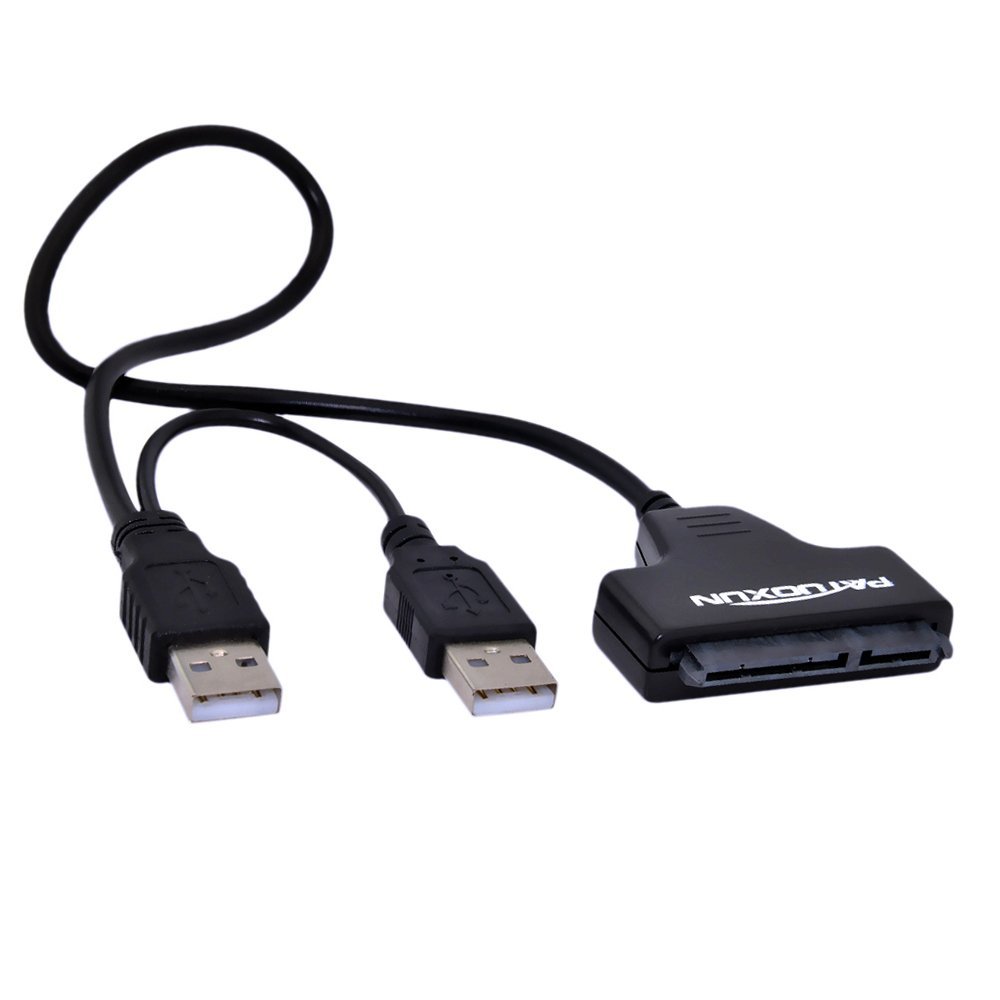

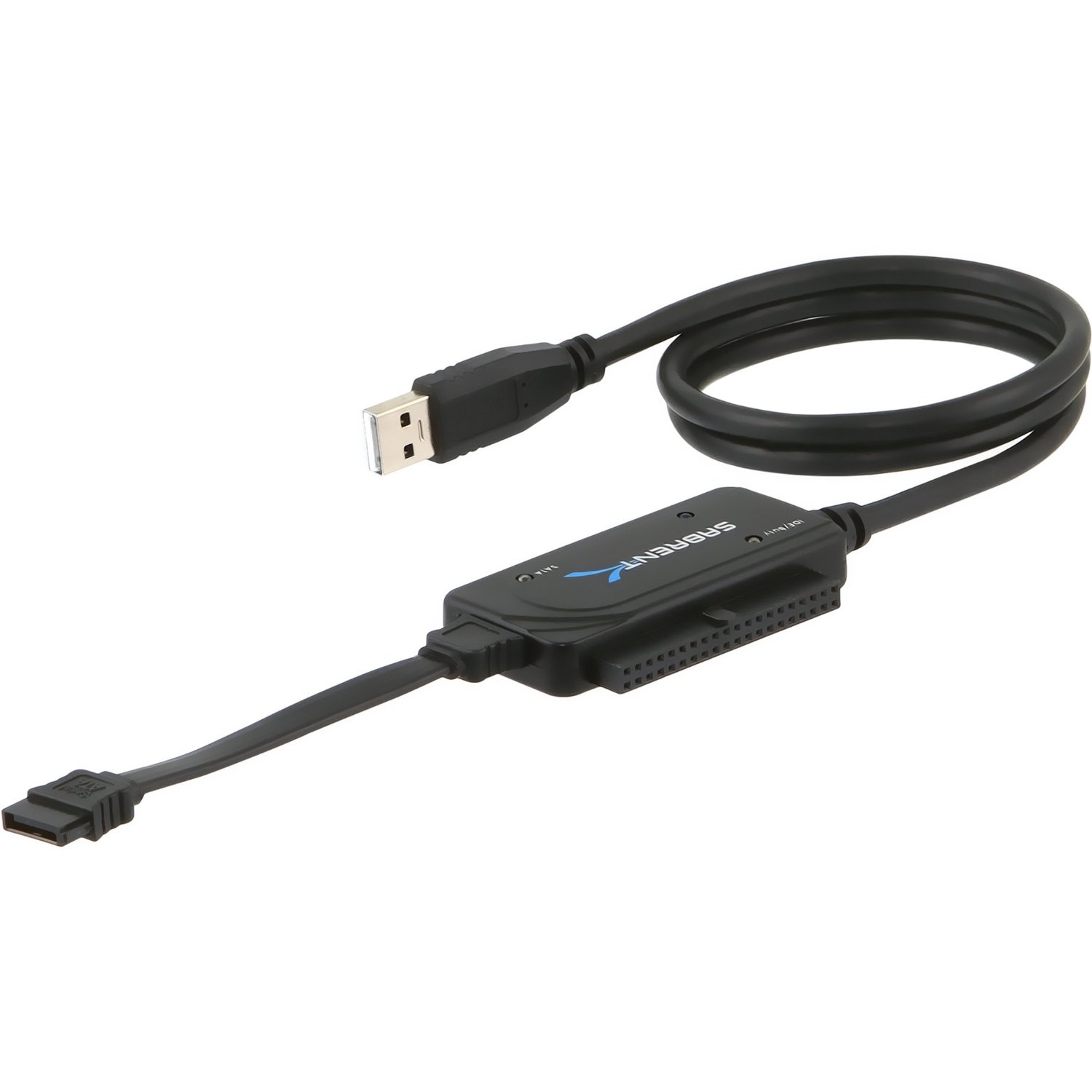

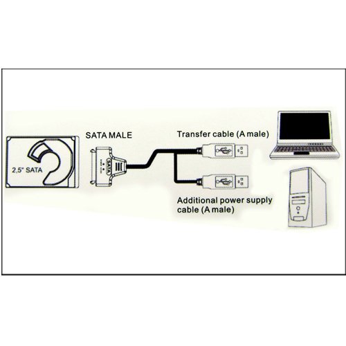

Thanks for the advice. I don't really want to get an external enclosure, so I was thinking just a cable to connect the bare drive would work. Are either one of these better for this purpose? One says it includes the power cable, the other appears to require connection to two USB ports (a laptop *and* a desktop in the diagram??)
http://www.amazon.com/Patuoxun-Converter-Adapter-Cable-Drive/dp/B008ASF5MC/ref=sr_1_1?ie=UTF8&qid=1396142909&sr=8-1&keywords=sata+to+usb+cable
http://www.amazon.com/Sabrent-Converter-Supply-Activity-EC-AHDD/dp/B00CPGYNV4/ref=sr_1_2?ie=UTF8&qid=1396142909&sr=8-2&keywords=sata+to+usb+cable
