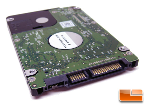

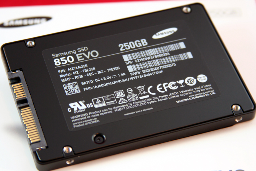

- The SSD (Solid State Drive) isn't strictly a Hard Disk Drive. But it serves the same function, has the same SATA connector, and has the same physical dimensions. It fits exactly in place of the existing hard drive without any extra bits needed.
An SSD has the advantage of, among other things, being several times faster and not having any moving parts.
Here are images of a Samsung 850 EVO SSD on the left and a traditional hard drive on the right.
We will all bully you into getting a SSD - but you won't regret it! 😛
Instead of a spinning platter inside, it's a bunch of memory chips. It works much faster. When I boot up with a SSD, it takes me 12 seconds. With the hard drive, it would take me 90 seconds. It's night and day and makes an older machine really fast.
