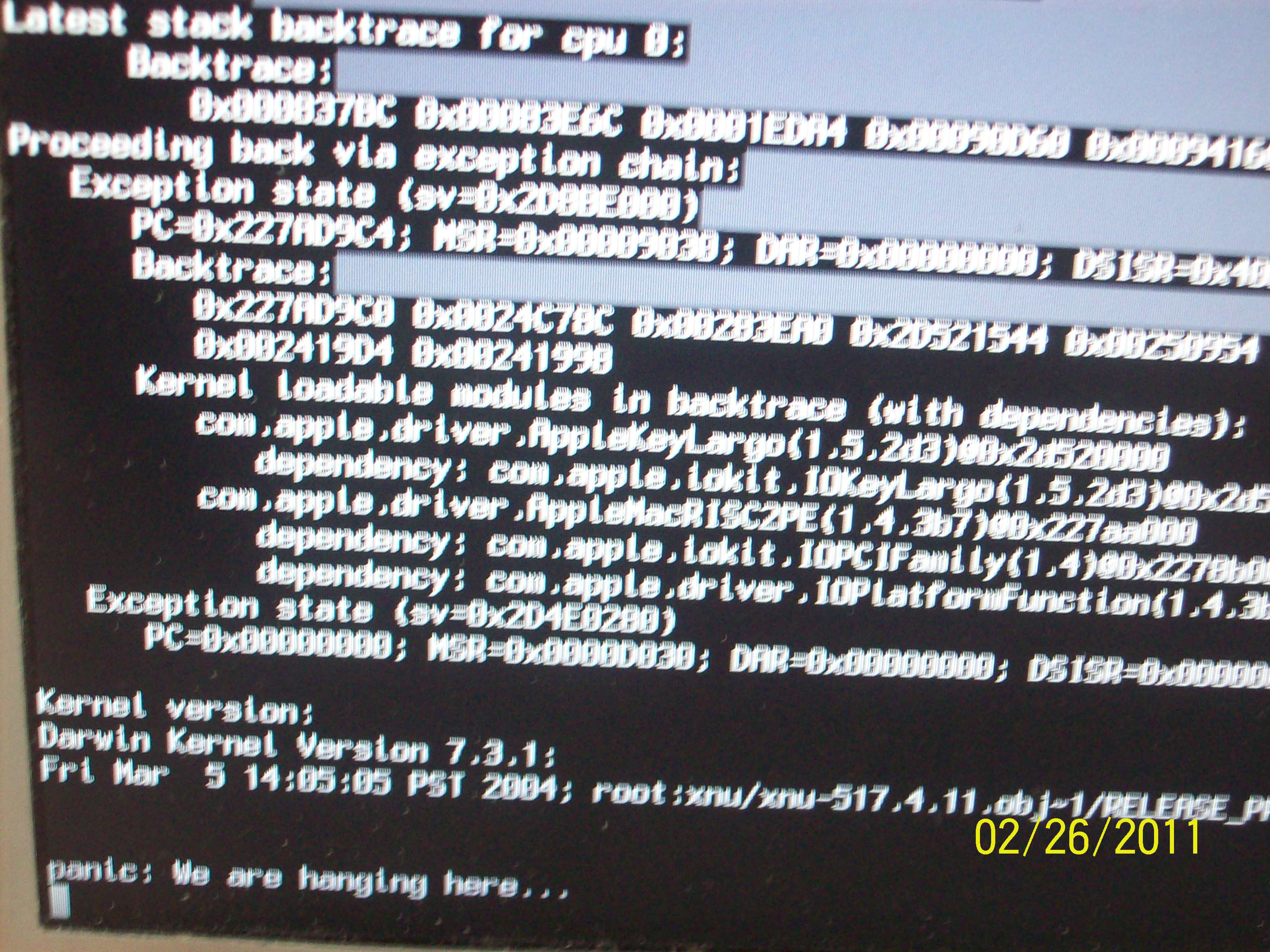

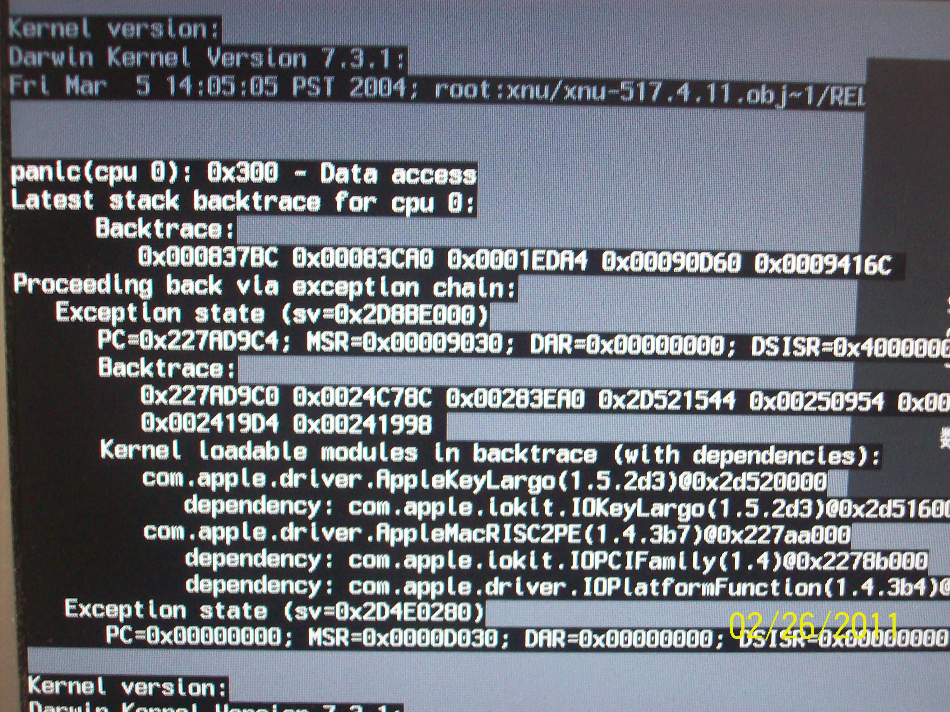

Now that I received a genuine 10.3 panther DVD (2Disc) and put it in to load, at startup held down the C key. I was shocked at what I received a black scrolling screen with a lot of information I do not understand, hopefully somebody can help me. The black screen had to much in formation for me to try and type. I took a couple of screen shots that I am attaching. 😕
The first thing to check is the particular model of the Powerbook. Go to everymac.com and see what the original system (pre-installed) was for your model. Some Powerbook G4 models came with 10.4 pre-installed and will not boot from a 10.3 disk.
