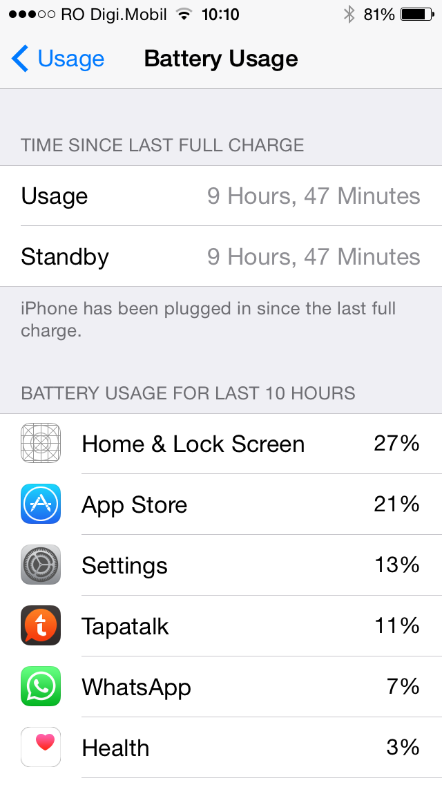

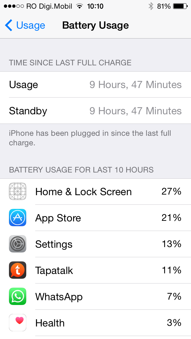

usage and standby shows the same time. battery drained 40% in 5 hours this night...
My battery life has been pretty normal during the day, but overnight it always goes from 100% to about 10%. I have no idea what it's doing overnight that kills the battery so much.
