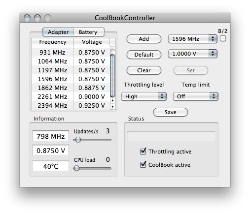

Since it looks like you have a C2D, everyone saying you can't undervolt is wrong; you can undervolt using CoolBook. I have undervolted my 2.4GHz 7,1 and love it, it makes a huge difference in both temperature and battery life
Awesome! That's the sort of reply I was looking for! Great I'll have a look into that. I guess I'm just considering temporary measures so my MBP lasts more comfortably before I upgrade.
